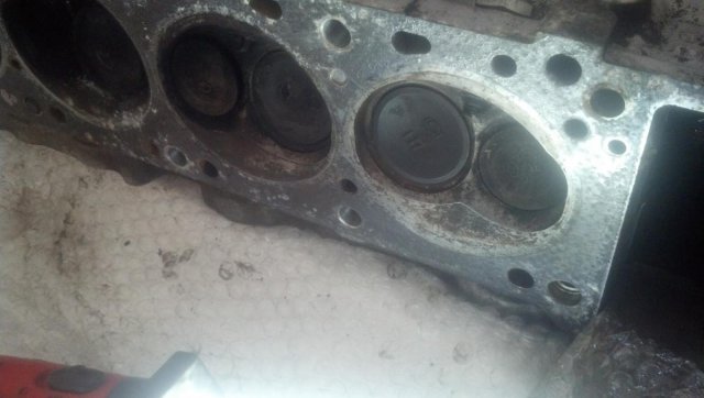

rejracer Posted March 5, 2013 Share Posted March 5, 2013 If you have the head off, the maxima N47 will have a closed chamber versus an open chamber of the 280z N47. What NewZed wrote is also true. Quote Link to comment Share on other sites More sharing options...

daddydonuts Posted March 8, 2013 Author Share Posted March 8, 2013 I got one on the way, now I gotta search for install advice Quote Link to comment Share on other sites More sharing options...
daddydonuts Posted March 19, 2013 Author Share Posted March 19, 2013 Now the fun begins, once I get the rest of my projects done. Quote Link to comment Share on other sites More sharing options...
