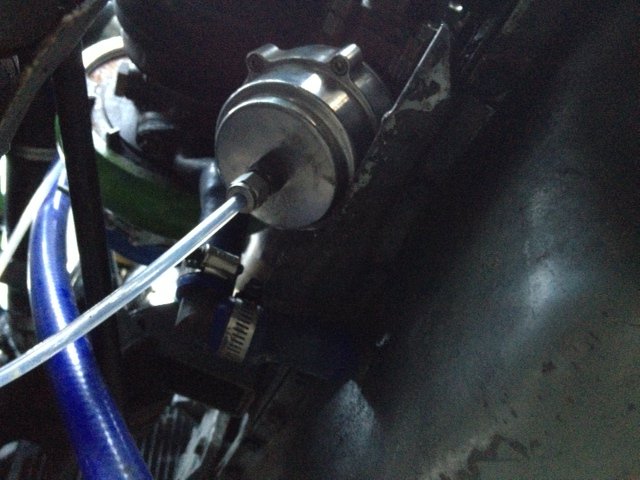

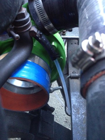

MaTTSuN Posted June 4, 2013 Author Share Posted June 4, 2013 well, good news and bad news Good news is i got my exhaust complete and my car running with the new turbo. bad news is it makes 20 psi, maybe more because i let off the throttle. I have my waste gate hooked up to the top of the waste gate, its a tail external I have a 7lbs spring in it but its way beyond 7 psi... any tips? here are some pics Quote Link to comment Share on other sites More sharing options...
Xnke Posted June 4, 2013 Share Posted June 4, 2013 That doesn't look right. Your boost line should be running UNDER the piston, so that boost pressure helps lift the puck. I think the way you've got it hooked up now, boost pressure is holding the wastegate shut. Quote Link to comment Share on other sites More sharing options...
MaTTSuN Posted June 4, 2013 Author Share Posted June 4, 2013 Just found that as well thanks for the quick reply, just took it for a drive and she makes about 8 psi and the screamer pipe sound pretty sick! once I figure out my wideband O2 then ill put the 15psi spring in Its funny how i can go from completely gutted too super happy in just mear moments Quote Link to comment Share on other sites More sharing options...
