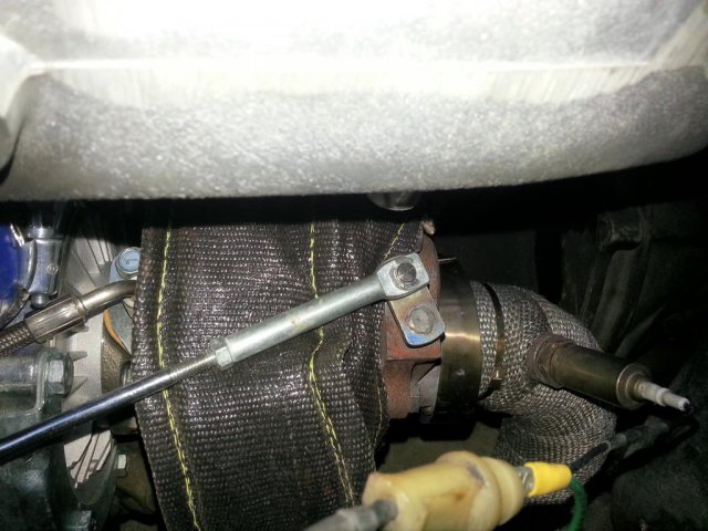

col10see Posted May 14, 2013 Author Share Posted May 14, 2013 Im thinking I want to lean it out a little low end any pressure recommendations for the turbo injectors. From what ive gathered its 36psi at idle with no vac... Also if I do that im guessing I want to get a fmu what ratio for 13 psi. 5:1? Hopfully soon I can find some doner dished pistons and rebuild the motor. Also heres a pic of the the turbo blanket.. Quote Link to comment Share on other sites More sharing options...
