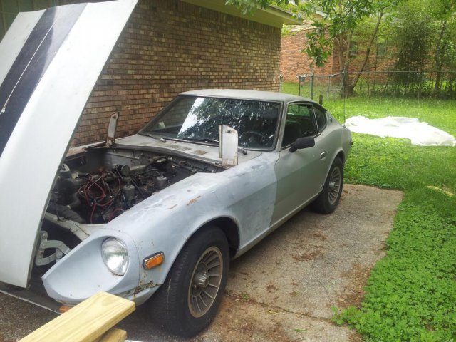

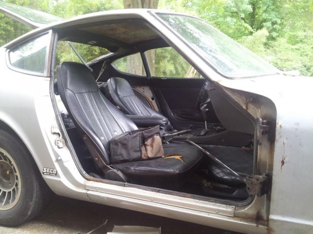

FLC Posted May 2, 2013 Share Posted May 2, 2013 I bought a 73 240z a few months ago and now that its warm outside i'm going to start working on it. About the car; it has a n42 l28 motor with a header and full exhaust I also have two round top carbs I stole off my other 240 to get it running so I could drive it home after I bought it. The car also came with a new 4bbl intake never installed but don't think i'm going to use it. Some sort of fancy ignition box I removed. Things I've done so far; new coil, cap, rotor, wires, brake master cylinder, clutch master cylinder, and some tlc. The car had quit working in 2009 and has been sitting inside since. The body has minimal rust a little in the battery box and maybe a fuzz towards the rear of the floor pans. Overall I would have to give it a 9 out of 10. The body does have some damage where you can tell its been in an accident the rear roll pan is rolled a little bit and the hood is rolled a little. I don't know what I have planned for it yet but i'm going to log my progress and answer any diy'ers question while i'm here if I can. Quote Link to comment Share on other sites More sharing options...

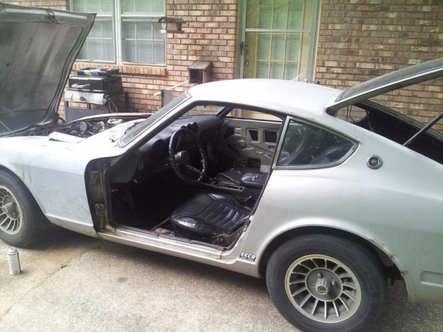

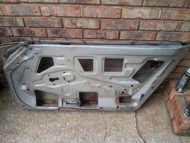

FLC Posted May 2, 2013 Author Share Posted May 2, 2013 Today on my list if it doesn't rain, fix the passenger side outer door handle (doors not open), adjust the door latch, disassemble the door and grease window track for smooth operation, and a general lubrication of all moving door components then reassemble. Not necessarily in that order lol. Quote Link to comment Share on other sites More sharing options...

FLC Posted May 3, 2013 Author Share Posted May 3, 2013 (edited) So yesterday I got the windows greased, doors adjusted, locks and latches lubricated and in good working order, and found out the door handle is broke so I need a new one of those. Joy! get to spend money on non crucial items. Pretty easy day. I think im going to take it to a shop today or next week and have it counter weighed. And take pictures of the weights so everyone on here can get a 100% no b/s weight of a bone stock 240z. Edited May 3, 2013 by FLC Quote Link to comment Share on other sites More sharing options...

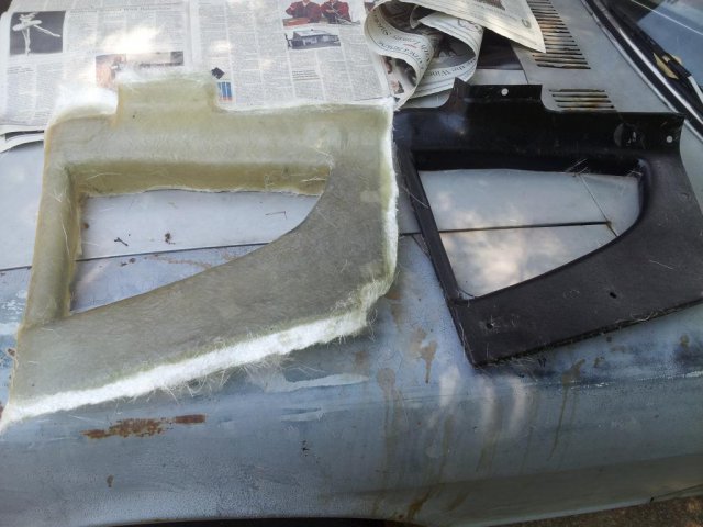

FLC Posted May 9, 2013 Author Share Posted May 9, 2013 Haven't got my car weighed yet, but I did start making molds for the interior. Hopefully theres a demand for replacement pieces. I'm probably going to offer a few different types; leather, vinyl, bare, painted,or carbon fiber. I'll post a few up on Ebay see how it goes. Quote Link to comment Share on other sites More sharing options...

1 tuff z Posted August 22, 2013 Share Posted August 22, 2013 Nice job on the mold for the 1/4 window trim. I think MSA offers reproduction panels but not certain. Guessing the fiberglass panels would be significantly stronger than the OE plastic models. Quote Link to comment Share on other sites More sharing options...
FLC Posted August 22, 2013 Author Share Posted August 22, 2013 Carbs are pretty pricey since most cars are fuel injected . The reason i went with carb, is because really the only thing i had to buy was the carb the intake and all the other stufff came with the car when i bought plus it keeps with the nostalgia kinda. Quote Link to comment Share on other sites More sharing options...
FLC Posted August 22, 2013 Author Share Posted August 22, 2013 Nice job on the mold for the 1/4 window trim. I think MSA offers reproduction panels but not certain. Guessing the fiberglass panels would be significantly stronger than the OE plastic models. Yes the fiber glass is supper strong no worries on cracking these things. Quote Link to comment Share on other sites More sharing options...
