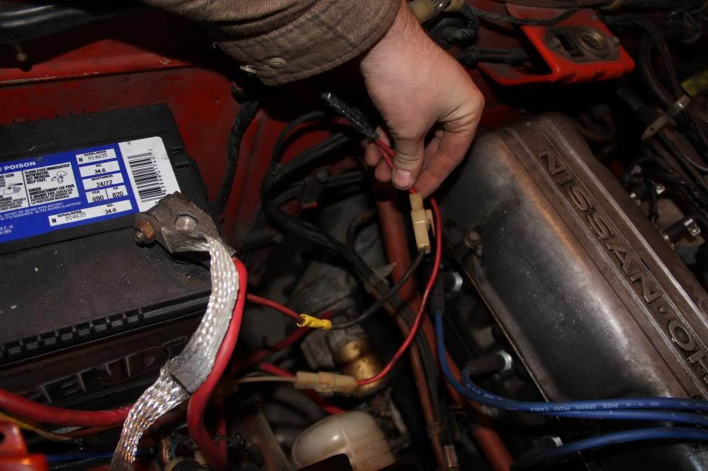

m1ghtymaxXx Posted May 6, 2013 Share Posted May 6, 2013 So today after wrapping up a painstaking exhaust build, I went to fire up my 1977 and nothing, no sign of any power whatsoever. Of the Battery, terminals, and fusible links seem fine. Unfortunately the car is stored out of town, and was supposed to come home today, so I'm thinking I'll might the trek out tomorrow evening. I was hoping to put together a checklist. Here's some background: - Car was put in storage last December, battery was disconnected immedialte - Building was broken into, wheels were stolen off my car, along with all my tools. car was rummaged through, but no signs of being vandalized - I did some work on the car, replaced transmission, diff, installed rear mount sway bar and built a new exhaust (was careful with ground placement). No electrical work done unless you count removing the starter for the trans swap. I did install a somewhat unkown ZX starter, but that seems irrelevant. Some suspicious things to note:http://i5.photobucket.com/albums/y174/m1ghtymaxXx/IMG_2609.jpg harness power wire look to have been replaced. They look like they're wrapped in electrical tape, but done very neatly. That's not factory is it? Also the abundance of connectors on the negative and positive side, along with some shady looking crimps. They do carry continuity though. Searching under the dash I found this: http://s5.photobucket.com/user/m1ghtymaxXx/media/IMG_2614.jpg.html Apologies for the blurry pic, but it's a plastic hose (similar to what might be used for rear window washers), wrapped in copper strand wire and insulated. It runs into the rocker through a factory looking grommet and I can't find the other end. It's clearly been slashed, but no sigh of what it connected into. I've been skimming through pages of search results, and the only relalvent thread I've found is this: http://forums.hybridz.org/topic/98327-240z-lost-all-electrical-power/?hl=no%20power it doesn't specify what year, but so far the voltage gauge is the first on my list of things to check. I still have to go over the wiring diagrams and see and make a list of a potential culprits, but if anyone can offer insight on typical issues that can cause this, it would be much appreciated! Quote Link to comment Share on other sites More sharing options...

m1ghtymaxXx Posted May 6, 2013 Author Share Posted May 6, 2013 So I take it the link in the first post regarding a similar problem being traced back to a voltage gauge is 240z specific. I found a nice colour wiring diagram here: http://4moores.com/280z/files/77_ZCAR-WIRING.pdf I would think the issue must lie before the fusible link box, since that seems to be the first distribution point between various harnesses. Also I guess the seemingly redundant connectors on the positive wire running along the firewall contain a length of fusible link. Does anyone know if the + and - that run along the firewall are spiral wound in what looks like electrical tape? Just wondering if that's factory. My current game plan is to jump a positive to the fusible link box and see if that remedies things. Beyond that I'm at a bit of a loss here. Quote Link to comment Share on other sites More sharing options...
