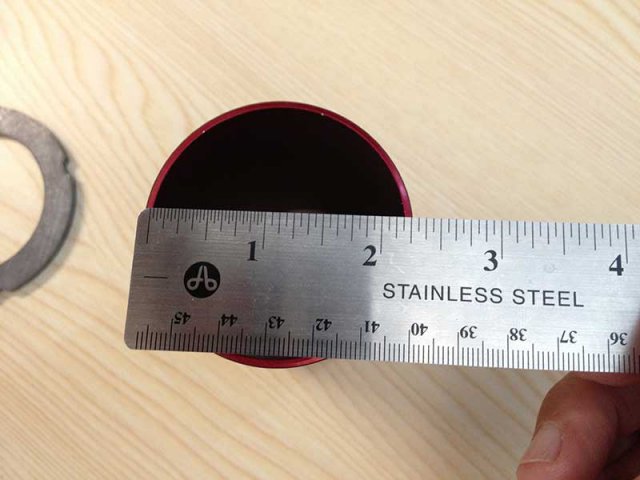

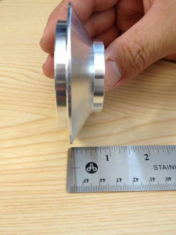

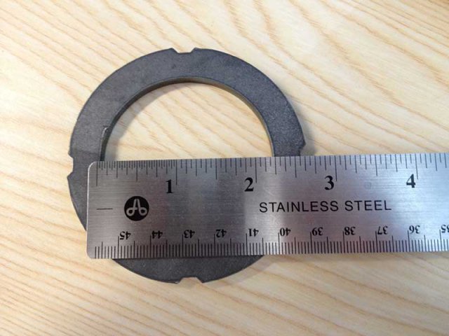

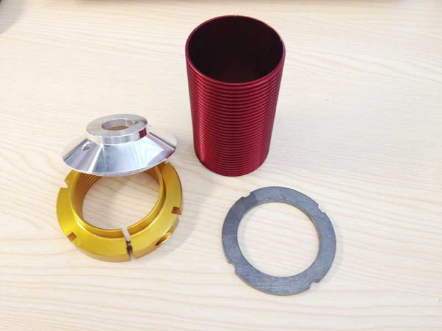

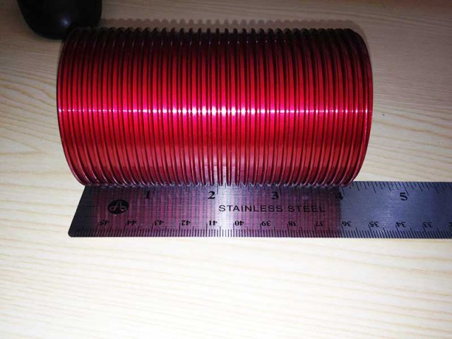

I ask GC to exchange 12" spring to 10" spring since I read this.
forums.hybridz.org/topic/85673-ground-control-coilover-installation-instructions/
My plan is using 4" sleeve with 10" springs 250lbs/275lbs.
Weld the ring 5.25" front, 8.25" rear.
However, once I use camber plate, the measurement will be changed.
I try to figure out how much strut tube I should cut off for both case using original strut insulator and Techno Toy camber plate.
