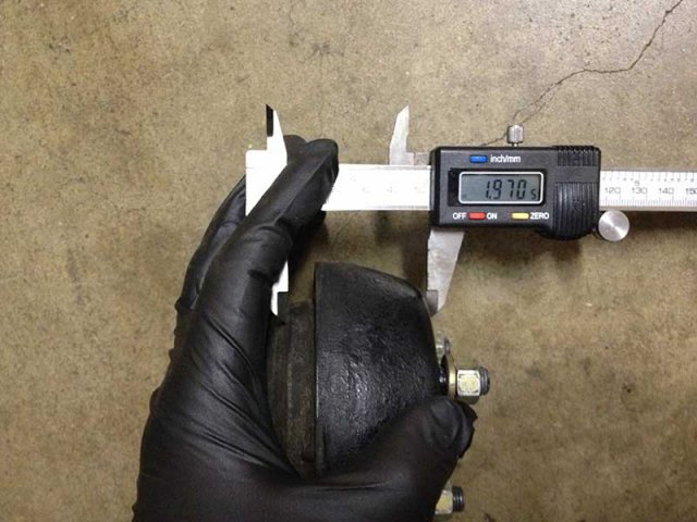

The height of front insulator is about 2" for 280z(as same as 240z)
The rear is 3" for 280z(240z should be 2")

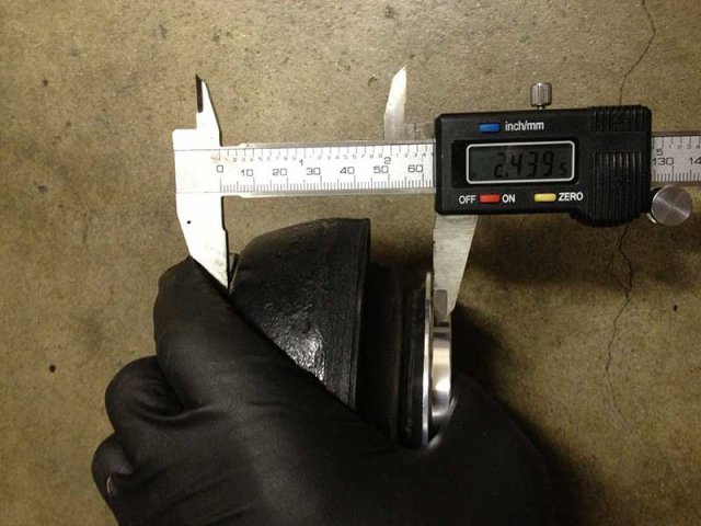

The factory default insulator with Ground Control top hat is about 2.5"

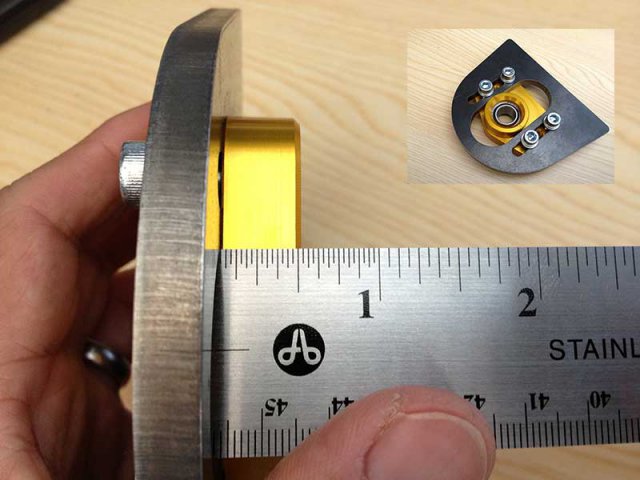

Techno Toy camber plate bottom part height is 0.5"
That means T3 camber plate bottom part with GC hat is about 1". Thus, it's 1.5" shorter than using factory default strut insulator.
