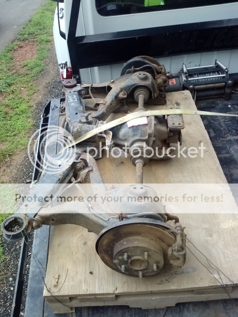

shupee Posted July 2, 2013 Share Posted July 2, 2013 OK I did the search thing and did not find the answer so-------- Can you tell the difference by looking short of pulling the P/S axle out?? I went from 0 LSD's to 3 in one week. scored on this one for $375 shipped--They told me it was a Shiro car but who knows. Then I scored this one on E-bay for $200 shipped which will be a good spare or use with the axles from the other http://www.ebay.com/itm/130937390039?ssPageName=STRK:MEWAX:IT&_trksid=p3984.m1423.l2649 I also bought a known SS Shiro set-up with axles for $150 from an undisclosed super top secret junkyard. Quote Link to comment Share on other sites More sharing options...
z240 Posted July 2, 2013 Share Posted July 2, 2013 (edited) I'de go buy a lottery ticket if I was you. Though with that string of luck, you might be just about dry... No way to tell C vs V without yanking an axle at least. Edited July 2, 2013 by z240 Quote Link to comment Share on other sites More sharing options...

RebekahsZ Posted July 2, 2013 Share Posted July 2, 2013 Congrats, you luck dog! Just pull the rear cover off - viscous looks very different internally. Viscous is heavier than a CLSD. Don't know how they "perform" any differently. I have been frustrated ted by my inability to get my CLSD to stop chattering and banging, so a VLSD may be a plus, especially for a street car. If you drag race your car, 3.90 is good for 1/4-mile, but kind of sucks for 1/8-mile. For 1/8-mile you would be better off with 3.54. Quote Link to comment Share on other sites More sharing options...
shupee Posted July 3, 2013 Author Share Posted July 3, 2013 Well I busted the rear in the pic apart and its a 3.70 CLUTCH LSD looks new inside axles and boots are near perfect. Well worth the $375 that I paid especially when they paid $160 to ship it from Oklahoma Quote Link to comment Share on other sites More sharing options...
JMortensen Posted July 3, 2013 Share Posted July 3, 2013 Look at adding clutches. There is a thread in the FAQ section. You'll need them with a V8 swap. Quote Link to comment Share on other sites More sharing options...
