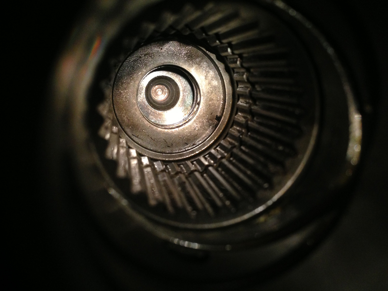

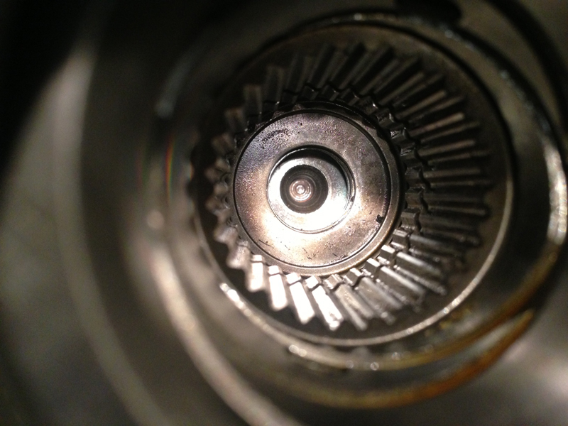

ericbauer Posted July 9, 2013 Share Posted July 9, 2013 (edited) Hi all I got a Quaife QDF7L for my long nose R200 rear diff in my 240Z According to the net it works in 280ZX / Z31 300ZX with both 10mm and 12mm ring gear bolts. It also works on shortnose R200 for S13/14 I don't have the earlier bolt-in halfshafts. I have the later style snap-in (circlip) half-shafts. While it's difficult to photograph, I managed to snap these two pics of the inside of the diff: You can see the groove in the Quaife where I'm guessing the circlip is supposed to retain the half-shaft. You can also see that there is no apparent threads in the diff for the early style bolt-in half-shafts. But neither the diff nor the half shafts have the retaining circlips... The half-shafts slide in and out freely... Not ideal... lol... I called Nissan and they had no p/n for a circlip on the diff side of 280ZX half-shafts Were they supposed to come with the Quaife? Any ideas where I can get some? Thanks all, -e Edited July 9, 2013 by ericbauer Quote Link to comment Share on other sites More sharing options...
NewZed Posted July 9, 2013 Share Posted July 9, 2013 (edited) Shows up here and here. Part #18. Who knows about real availability. On the Z and ZX R200's it installs in the internal groove in the diff. before you insert the axles. Later axles (the VLSD's for example) had it installed on the axle itself (may be why there is none in yours). Check groove sizes, chamfers, etc. to make sure you don't get an axle stuck. Someone who knows Quaife's could advise better for your situation. http://www.carpartsmanual.com/datsunS30/DatsunZIndex/PowerTrain/DifferentialGear/R200/tabid/1727/Default.aspx http://www.courtesyparts.com/clip-side-p-351272.html Edited July 9, 2013 by NewZed Quote Link to comment Share on other sites More sharing options...

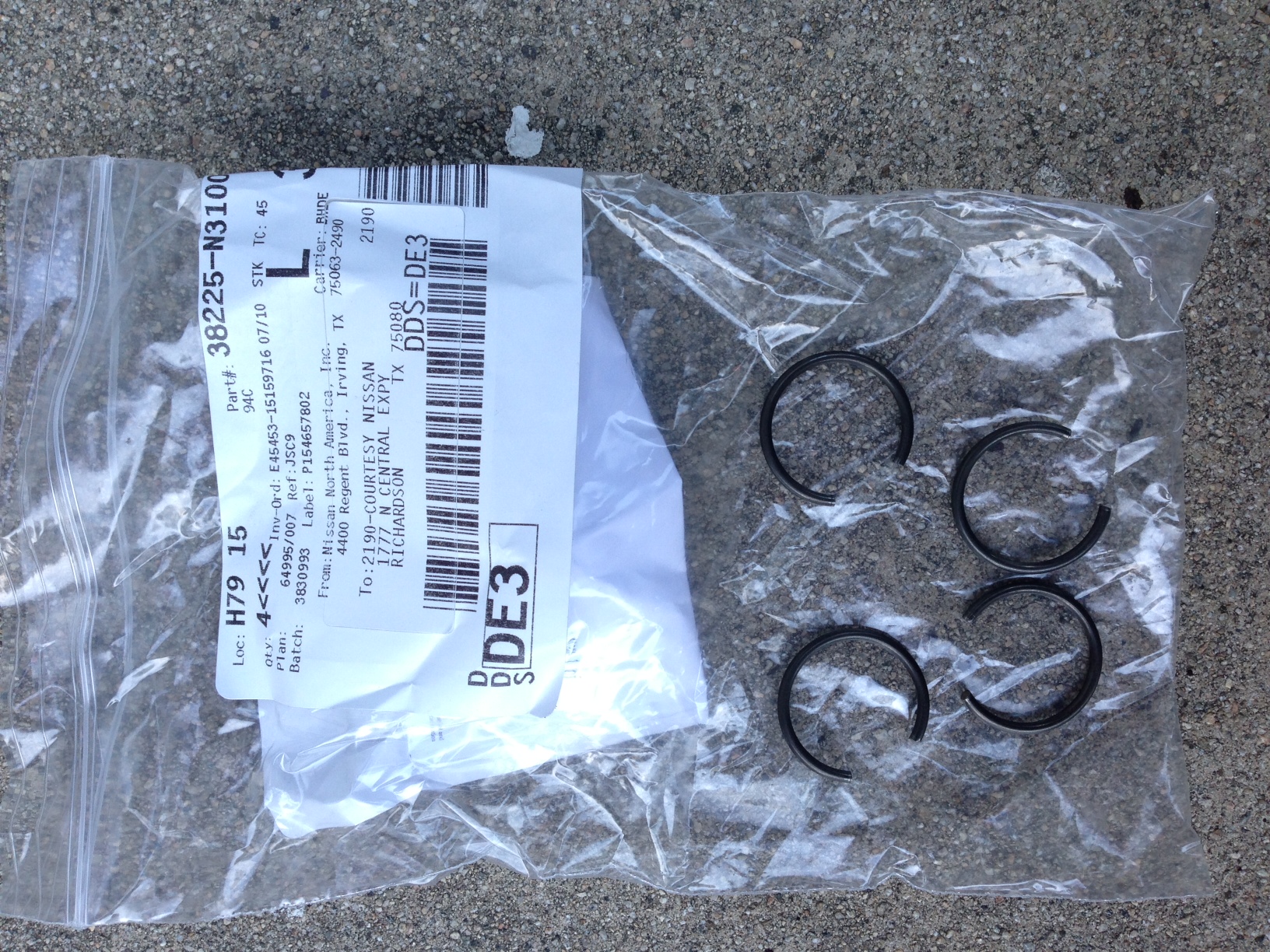

ericbauer Posted July 21, 2013 Author Share Posted July 21, 2013 (edited) In case anyone's curious, here are the R200 circlips Nissan part number 38225-N3100 27mm ID, 32mm OD I popped them in earlier today and they worked a-ok - axles are now securely held in place. Edited July 21, 2013 by ericbauer Quote Link to comment Share on other sites More sharing options...
