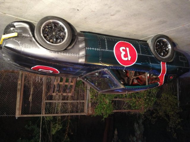

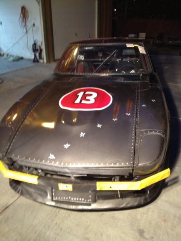

Oaklandjester Posted August 2, 2013 Author Share Posted August 2, 2013 Slotted the towers, cut the hats down. Relocated the lac bushings much better finished the paint to look like a zero al la forza zero 240 z not bad for a driveway paint job and a harbor frieght airbrush, Quote Link to comment Share on other sites More sharing options...
