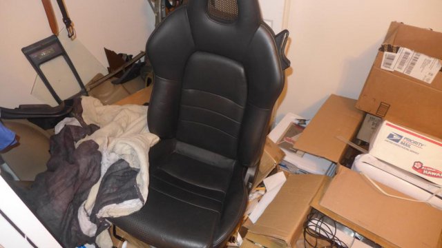

invalidusername Posted September 23, 2013 Author Share Posted September 23, 2013 Here is the driver side seat. The passenger seat is in pieces for bracket making and heated seat kit assembly simplicity I got the pair for 300 bucks off a guy who put racing seats in his honda....I love craigslist. I was able to get some pretty mint (as in, not broken) interior parts off of a friend of mine in Columbia, so I may be doing a little more interior work between welding/cutting and scraping. And for those who don't know, if you are reading this.....DRY ICE is the best way to get the sound deadening material off of the floor pans. Lay it on till it freezes, tap it with a ball peen and viola, clean floor, no sweat needed. Quote Link to comment Share on other sites More sharing options...

Domzs Posted September 23, 2013 Share Posted September 23, 2013 (edited) I like those seats . What model Honda ? I got some cheap Ebay seats , they look good but cheap a** materials , wouldn't them rec. to anyone . I was thinking of a pair of Z32 seats or Z33 , love my Z32 seats . I'll be awhile before I start ( restart ) on my S130 , doing body and interior work on my S30 right now , too many projects are going on at one time . . The Z32 soon will get an LSx too ( at least 2 years from now , emissions reason ) . Edited September 23, 2013 by Domzs Quote Link to comment Share on other sites More sharing options...
invalidusername Posted September 23, 2013 Author Share Posted September 23, 2013 I like those seats . What model Honda ? I got some cheap Ebay seats , they look good but cheap a** materials , wouldn't them rec. to anyone . I was thinking of a pair of Z32 seats or Z33 , love my Z32 seats . I'll be awhile before I start ( restart ) on my S130 , doing body and interior work on my S30 right now , too many projects are going on at one time . . The Z32 soon will get an LSx too ( at least 2 years from now , emissions reason ) . Trust me I understand the "too many projects", I have quite a few going on myself at the moment. The seats are out of a S2000, love them, little huggy on the thighs though, then again, Im a pretty big guy, but they feel good on the back. Quote Link to comment Share on other sites More sharing options...
