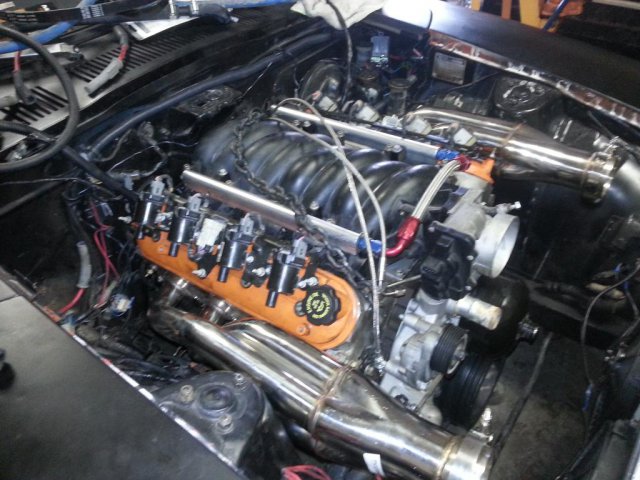

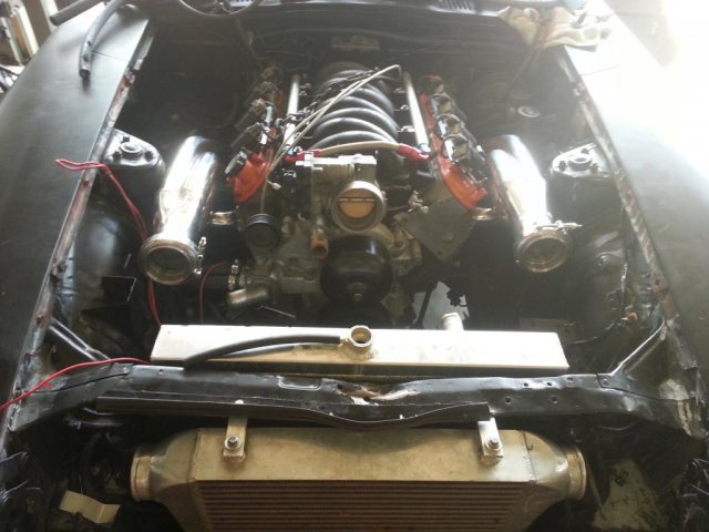

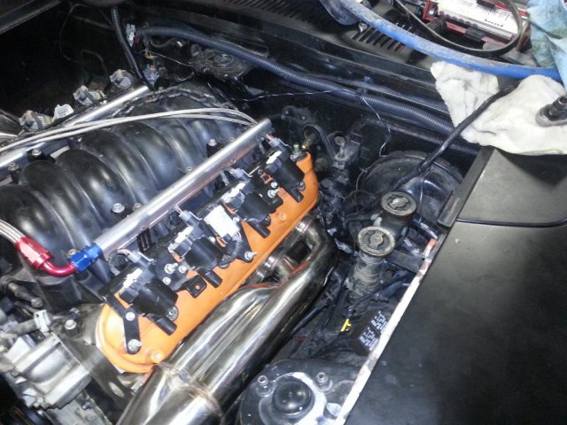

mattd428 Posted August 31, 2013 Author Share Posted August 31, 2013 Time for an update. The OBX headers off of ebay fit.........they are tight but they do fit. I had to do a little massaging to a strut tower about 1/4". Turbo mounting is going to be tough not a whole lot of room. Might just break down and move the radiator. But hey she is partially back together. Other issue is the coils will have to be relocated no room for plug wires. 1 Quote Link to comment Share on other sites More sharing options...

RebekahsZ Posted August 31, 2013 Share Posted August 31, 2013 Wow, that's pretty! Solid mount the motor and you shouldn't have trouble with hitting things due to engine movement? You are gonna have one hot hood! But, that's so pretty you should run without one. Quote Link to comment Share on other sites More sharing options...
mattd428 Posted August 31, 2013 Author Share Posted August 31, 2013 The motor is solid mounted by replacing the biscuut mounts with aluminum blocks and the trans is a solid mount also. There shouldnt be any issues with the motor moving.......unless I break a mount. (knock on wood) That hood is going to be cooking thats for sure. No hood would be easier. Quote Link to comment Share on other sites More sharing options...
