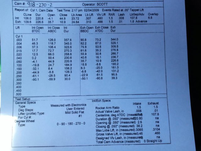

If you look at pages EM-29 and EM-30 in the 1976 Engine Mechanical chapter you can derive 1.5 and/or 1.6 ratios yourself.  If you calculate in the hot lash numbers you'll get ~1.53 (intake and exhaust different), if you ignore lift lost to lash you'll get 1.57.  Both above 1.5, no way to round down to 1.4.
Later FSM's, ZX's for example, don't have enough numbers to do the math.
You can also do the math in Delta's spec sheet.  Those are all measured numbers.  Theirs comes out to 1.5 (.466/.3104).  Subtract the lash out and you get 1.47.
I'm just doing math on numbers available, not real rocker arms.  Delta actually measured the lift on ww240z's cam, so the math is kind of moot for his wonderings.  Looks like they added lash back in to get "gross".
The bulk of the internet and literature uses 1.5, so the fight to change thinking to 1.4 will be a good one.
