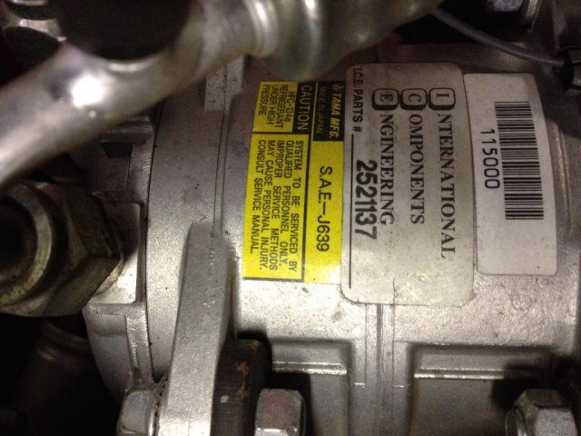

Phantom Posted April 20, 2014 Share Posted April 20, 2014 (edited) On 4/8/2014 at 10:10 AM, socorob said: I would use the mounts again, but not the radiator hoses or AC stuff. Maybe just the AC bracket and compressor to keep from having to make your own mounts, but I would get the hoses,drier, and the rest of the AC system from vintage Air. I wasn't happy that he uses an AC compressor that's made in China. I'm hoping a sanden will bolt into the same place when this one fails. The JTR headers fit well. I am mostly pleased with everything I used so far.FWIW - Here is a photo of the AC compressor that JCI installed in my car in 2004. It is still working great. Hope it helps. Here's a link to a website that sells them. http://www.techchoiceparts.com/inventory Edited April 20, 2014 by Phantom Quote Link to comment Share on other sites More sharing options...
socorob Posted April 20, 2014 Author Share Posted April 20, 2014 The new ones he sends are made in china from a company called omega. Quote Link to comment Share on other sites More sharing options...
