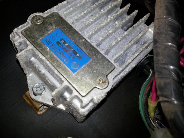

1974 was the year that Nissan introduced electronic ignition to the US market Z cars.  No more points.  Looks like someone just swapped L24 engine parts in but kept the better 260Z electronic ignition with its distributor.  Look under the passenger dash by the fuse box and you'll probably see a neat looking aluminum box with cooling fins on it.
Ah, it is there. Little out of the way so I hadn't noticed it before.
My auto tech teacher pointed out the magnetic pickup in the distributor the other day and said "Oh you've got electronic ignition on here"
Is this kind of distributor similar to the ones they had on the 280z that were 'magnetic trigger' design I believe? And much different from the D6K82-02 280zx distributor I have as well?
I am going to guess the current distributor came from the car like you said, it also has an N36 intake which was also from the L26 right? The whole engine is an interesting mix of L24 and L26 bits.
