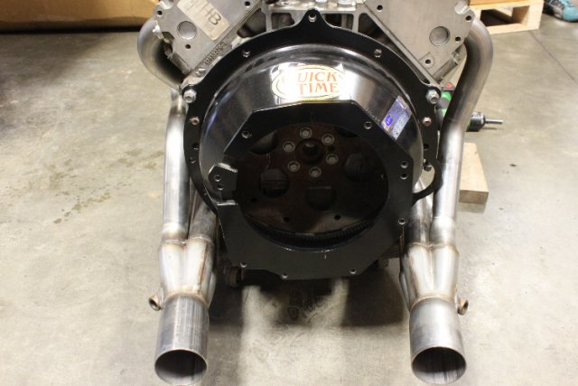

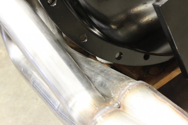

fullmetaljacket Posted September 26, 2013 Author Share Posted September 26, 2013 Hi,Here are the pics confiming the headers will clear a Quicktime SFI approved bellhousing. Motor mount pricing is in and will consist of 4 custom pieces along with an Energy Suspension polyurethane motor mount kit will cost $299.00. I will post more pics of these once the first as shipped set comes in from my prototypes. Please let me know your thoughts as I am in the process of confirming these headers will fit the 240 chassis as well. Thanks again. Bruce Hawkins Quote Link to comment Share on other sites More sharing options...
RebekahsZ Posted September 26, 2013 Share Posted September 26, 2013 OMG those look good. Starter clearance? Do you have to remove header to remove starter or oil filter? Many of us have already installed with the JCI kit-perhaps you can get a set test fit on a car that is so equipped. Otherwise your header market will be limited to future conversions. Quote Link to comment Share on other sites More sharing options...
fullmetaljacket Posted September 26, 2013 Author Share Posted September 26, 2013 OMG those look good. Starter clearance? Do you have to remove header to remove starter or oil filter? Many of us have already installed with the JCI kit-perhaps you can get a set test fit on a car that is so equipped. Otherwise your header market will be limited to future conversions. Thanks, oil filter comes off great,the header does need to be unbolted to R/R starter but the fbody starter works great. On the subject of motor mounts there are numerous mounting options and I am reproducing mine as well , I will not be able to chase ALL of the others the headers were not designed around for abvious reasons. but a motor mount change would be worth these headers I can assure you . Thanks again for the feedback, Bruce Quote Link to comment Share on other sites More sharing options...
