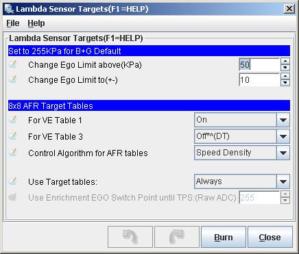

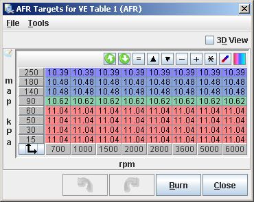

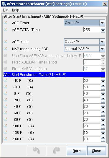

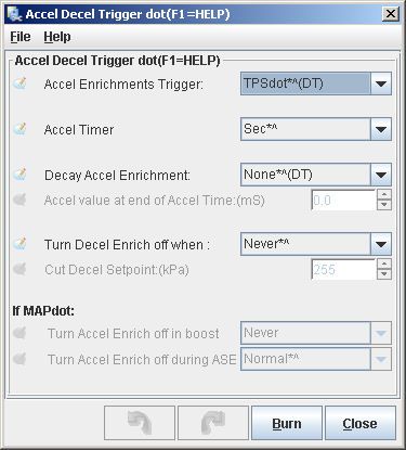

beaniam Posted December 29, 2013 Author Share Posted December 29, 2013 (edited) here's how things look Edited December 29, 2013 by beaniam Quote Link to comment Share on other sites More sharing options...
Metro Posted December 29, 2013 Share Posted December 29, 2013 Your AFR targets table is, well, probably the source of all your tuning issues. VEAL uses that table to tune and it's set to tune everything super rich - 10-11:1 AFR. You need to configure the table with the AFRs you want. With my old setup, cruising KPA was around 45-70, so set those as lean as you want for fuel economy, the rest is up to you. Quote Link to comment Share on other sites More sharing options...
beaniam Posted December 29, 2013 Author Share Posted December 29, 2013 (edited) Weird because this is the tune that runs well. I can smell that it's rich but there's no surging or bucking under boost. When I start running analyze live on this tune is when that starts. edit: just realized my links were messed up. I see what you mean now. I'll have to bump them up to around 13-14. Edited December 29, 2013 by beaniam Quote Link to comment Share on other sites More sharing options...
Chris83zxt Posted December 30, 2013 Share Posted December 30, 2013 Weird because this is the tune that runs well. I can smell that it's rich but there's no surging or bucking under boost. When I start running analyze live on this tune is when that starts. edit: just realized my links were messed up. I see what you mean now. I'll have to bump them up to around 13-14. Running sequential fuel/spark I've found my tired old l28et does fine in the cruise areas up to around 15.5 afr on 87 pump gas (flex sensor bounces between 7-8% ethanol). Anything lower than 12.0 in any area and you're probably not making any extra power, just wasting gas. Looking at your ve table I'd say the surging you're experiencing is probably because you're set too rich at higher rpms. Depending on what you've done to your motor your peak torque is going to be somewhere in the 4,200-4,800 rpm range, and the ve table values will peak in that range and then start falling off again. When I started my tune off I made sure that all my upper ve table was pretty far on the rich side, and let VEAL pull fuel from the cells over numerous wot runs. I would experience bogging every time I hit a too-rich cell, but the problem would get better over repeated runs as VEAL pulled fuel to get the AFR into range. Quote Link to comment Share on other sites More sharing options...

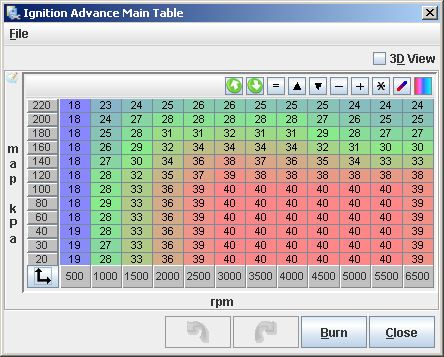

Chris83zxt Posted December 30, 2013 Share Posted December 30, 2013 After looking at all of the values there are some more problems. Turn off accel and decel enrichment while tuning the VE table. Your warmup enrichment curve should end at 100% in the final row, not 96%. That is also a pretty aggressive timing table. I think by 220kpa I'm down to 14 degrees or so around peak torque rpm. My values were derived by looking at existing maps from long term users here. I do not personally know whats 'safe' to run at what kpa, but those values are definitely on the higher side of what I've seen. Quote Link to comment Share on other sites More sharing options...

beaniam Posted January 7, 2014 Author Share Posted January 7, 2014 I went to mess with it some tonight and when I went to look at the AFR targets for VE the values are showing up in voltage. What did I do for this to not be showing up in AFR values? Quote Link to comment Share on other sites More sharing options...
Chris83zxt Posted January 7, 2014 Share Posted January 7, 2014 I went to mess with it some tonight and when I went to look at the AFR targets for VE the values are showing up in voltage. What did I do for this to not be showing up in AFR values? There's an option in your project settings that sets whether your want AFRs displayed in the traditional gas format (14.7 stoich) or lambda (1.0). Voltage might be one of the options too. Quote Link to comment Share on other sites More sharing options...
beaniam Posted January 7, 2014 Author Share Posted January 7, 2014 Somehow it changed my WB sensor selection to unknown from AEM. I'll mess with it more when it's not a 5 degree night. Quote Link to comment Share on other sites More sharing options...
