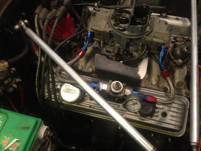

fyanrudger Posted January 6, 2014 Share Posted January 6, 2014 Went on a spirited canyon drive on New Year's day with some friends and started experience a fuel pressure issue half way through the morning. Car began bucking/wanting to die/dying at cruising RPMS, but was find at WOT and above 3.5/4k rpms. Fuel pressure gauge is usually ~5psi, but I noticed it was sitting at ~1psi and would even die at idle. If I go downstairs and start the car right now, fuel pressure will be normal again, so I assume this has to do with the hard driving/heat. Is this a premature sign of a failing fuel pump (running a Carter 4600hp) or a vapor lock issue? No return fuel line and the line is routed down the tunnel, but not close to the exhaust at any point. Thanks! Dirty engine photo: Quote Link to comment Share on other sites More sharing options...

ThreeEightyZ Posted January 14, 2014 Share Posted January 14, 2014 (edited) Are you sure that your pressure gauge is good? As well as your regulator? If it pulls fine when you roll on the throttle or at wot you are most likely running rich. It sounds just like when a bowl starts to flood from a float problem or too much pressure. Actually...i just looked at the picture...you're running a Mr Gasket gauge from the parts stores. Those are useful when you need them immediately...but they are JUNK. I have one on my car and I have gone through 4 of them in a year because after a month or so they stop reading even REMOTELY correctly. I actually just changed one last week because I was having this exact problem..turned out my actual fuel pressure was 12+ when the MG gauge was reading 5. Edited January 14, 2014 by ThreeEightyZ Quote Link to comment Share on other sites More sharing options...
fyanrudger Posted January 14, 2014 Author Share Posted January 14, 2014 Are you sure that your pressure gauge is good? As well as your regulator? If it pulls fine when you roll on the throttle or at wot you are most likely running rich. It sounds just like when a bowl starts to flood from a float problem or too much pressure. Actually...i just looked at the picture...you're running a Mr Gasket gauge from the parts stores. Those are useful when you need them immediately...but they are JUNK. I have one on my car and I have gone through 4 of them in a year because after a month or so they stop reading even REMOTELY correctly. I actually just changed one last week because I was having this exact problem..turned out my actual fuel pressure was 12+ when the MG gauge was reading 5. I don't believe it's the gauge, as the car is actually dying when the gauge is reading ~1psi and adjusting the gauge when cold brings the psi up or down...although adjusting it while hot (while I was having the issue) did not bring the pressure up at all, which led me to believe it's the pump. Quote Link to comment Share on other sites More sharing options...
