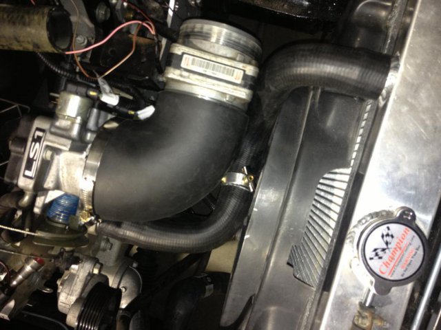

socorob 5 Posted January 14, 2014 Share Posted January 14, 2014 I ended up using the JCI supplied hose for the top hose. I cut it to install the steam vent and flipped one side. I think the part number is gates 21588. I had to cut 1 inch off the intake elbow where it goes onto the throttle body to make clearance for the hose to pass between it and my fan. Quote Link to post Share on other sites

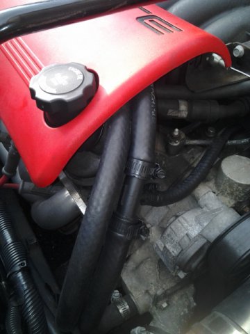

PLATA 19 Posted January 14, 2014 Author Share Posted January 14, 2014 (edited) So Gates 21588 for upper, 21503 for lower, that's the ticket. BTW this is what I did for the steam vent tube >> Edited January 14, 2014 by PLATA Quote Link to post Share on other sites
