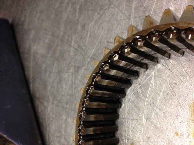

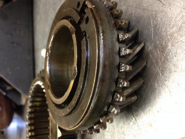

So my freshly installed early 280ZX five had the common popping out of fifth gear syndrome. So I pull the trans hoping it's the loose main shaft nut issue and what do you know, the nut was tight. Upon further disassembly it turns out my trans guy says it's the fifth gear blocking/fiber ring and slider as picture. Anyone have any idea where I can get these parts new? I really need the fiber ring and the Transtar books says it's no longer available.
We may also try the parts of out a similar 4x4, anyone have any experience with any of this non sense?

Yeah. Hopefully they send the right parts. I talked to a tech who seemed to know what he was talking about. For those interested the 5th ring gear is NIS-5 ($95) and the ring and bearing kit is BK104WS ($159). Hopefully I get the right parts.
