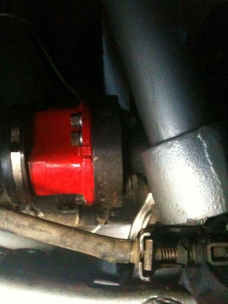

Eric JB Posted July 31, 2015 Share Posted July 31, 2015 Has anybody made the 280ZXT 3x2 adaptor from Cygnusx1 (download from post #3 above) and is it not as thick as the ones that were/are being made for MM and now Chequered Flag? Anybody currently running the Cygnusx1 3x2 adaptor and 280ZXT axle combo on a 280Z? Bringing this thread back from the dead to answer year old questions. Yes, I made some 280zxt adapters based on the drawing. I found 1.100 to be a bit thick, so I cut them down to 1.00. I then bolted them to the flanges and welded them together. No problems to date, but I have an auto and preload before matting it. Quote Link to comment Share on other sites More sharing options...
