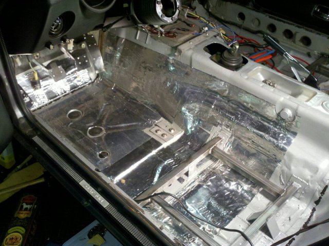

skerry Posted March 13, 2014 Author Share Posted March 13, 2014 (edited) Thanks guys! I looked at a bunch of different products and I just can't seem to get excited about any of it. I looked at lizard skin but I kind of have an extreme case in both sound and heat where I felt it wouldn't be enough on its own. I really wanted something that would reflect and absorb on the bottom side because that console is hot. Im thinking this underneath the car http://store.secondskinaudio.com/1-sheet-of-thermal-block/ I found this stuff tonight for the inside. http://www.lobucrod.com . I was leaning towards a butyl or rubber based material because I was scared of it holding moisture but at that price I may have to take a shot. Edited March 13, 2014 by skerry Quote Link to comment Share on other sites More sharing options...

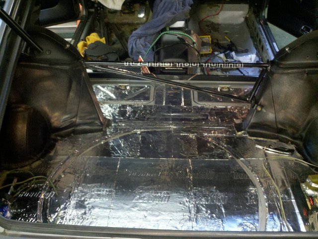

socorob Posted March 13, 2014 Share Posted March 13, 2014 Do you use that strutbar for harness mounts? Do you think it would be strong enough for that? That looks like it would be a simple idea for a removable harness mount if the strength is there. Quote Link to comment Share on other sites More sharing options...
skerry Posted March 13, 2014 Author Share Posted March 13, 2014 I'm going to POR-15 my floors, then a butyl rubber with aluminum backing (hushmat), then the CSF from lobucrod. Should really be nice when done. I ended up getting 25 square feet of the mega mat by fatmat to put into the passenger area and around a fuel cell can that I have. I'm ordering the carpet kit from thezsource unless you guys have something better for that? Thanks again for the replies Quote Link to comment Share on other sites More sharing options...
