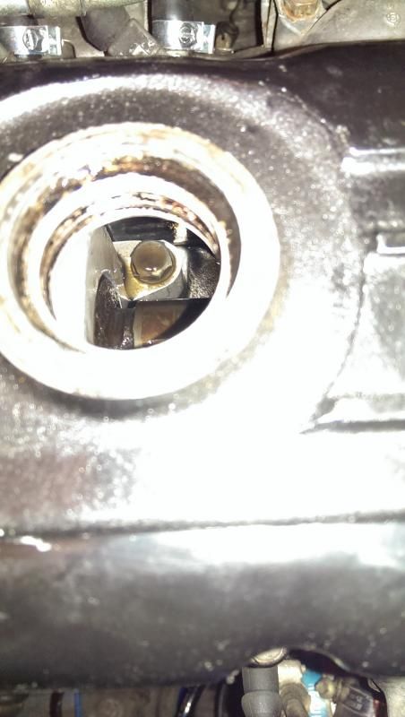

Haven't popped off the valve cover yet, checked/adjusted timing, or if motor is even TDC from previous owner/rebuilder.
Due to it being rebuild I want to get a baseline before going off the edge and pull everything apart..
Hopefully once I pull the cover the rest of the head looks this clean:
So where to go from here? Edited by AdreView
