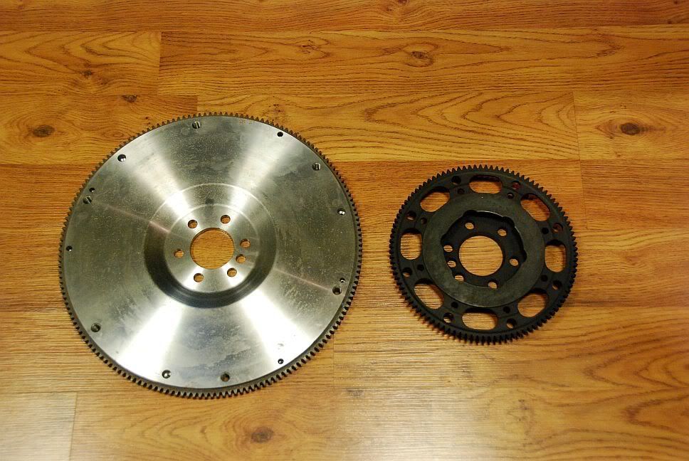

I assume you're asking about the button clutch? I took the lazy way and bought everything together as one package. Tilton part number 52-33130. It's a triple disc 5.5" for LSx. Includes everything in this picture...
Side by side of a stock sized flywheel...

Yup. Sort of. 38lbs less than a Monster Stage II clutch with 18lb flywheel. But I believe that package is nearly identical in weight to the stock stuff.
