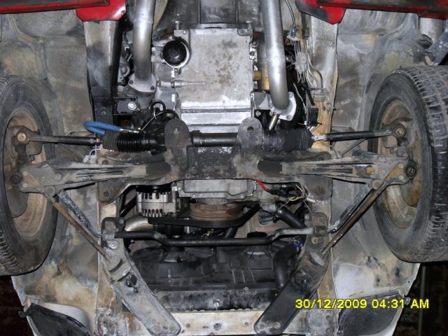

Domzs Posted April 18, 2014 Share Posted April 18, 2014 I don't think front sump will work . Here's mine . Quote Link to comment Share on other sites More sharing options...

Domzs Posted April 21, 2014 Share Posted April 21, 2014 I think those pans are too low for ground clearance . Fbody fits flush with the Xmember . Modified Fbody or C6 Vette pan have better ground clearance . Quote Link to comment Share on other sites More sharing options...
