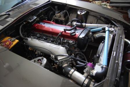

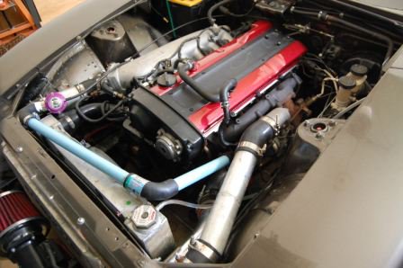

Vandergriff84 Posted May 1, 2014 Author Share Posted May 1, 2014 I am starting to get the picture of the fumes entering through the back which makes sense as there are all new seals on the exhaust. I will probably take a look at this once I get the fumes sorted out. I don't recall having this problem with the 78 280z I had in the early 2000s. As far as the venting goes I tried to run everything as it was on the stock setup. PCV hose goes from the Freddy intake to the PCV check valve on intake valve cover and then there is the pipe that connects the intake cover to the exhaust cover that Ts off and goes to the intake pipe just before the turbo. I have the stock Throttle body connected with a 1/2" adapter plate that I made for clearance. I have the Greddy BOV just in front of the TB and is circulated back to the intake pipe just before the turbo. I don't really understand how the Freddy intake could make such a difference in the way that it runs but at the same time it is the only major change from the stock setup. What would be a reasonable FC for the money since I don't really care to make ton of power? I know that Nistune is not that expensive in comparison to AEM and what have you but I haven't found anyone here that is running it on their car yet. Quote Link to comment Share on other sites More sharing options...
CasperIV Posted May 2, 2014 Share Posted May 2, 2014 Is that a piece of PVC pipe functioning as a re-circulation line? Quote Link to comment Share on other sites More sharing options...
Vandergriff84 Posted May 2, 2014 Author Share Posted May 2, 2014 Its actually Aluminum, it has a Teflon coating on the outside of it. It was leftover from the compressed air lines I ran in my shop. I am planning to relocate the BOV to the other side of the intercooler to clean things up a bit. Some one gave me the BOV with a bunch of piping and that was the only place that it would work so I went with it. There is one piece of PVC under the throttle body for the idle air control. I couldn't find any metal piping that size at the time. Quote Link to comment Share on other sites More sharing options...
