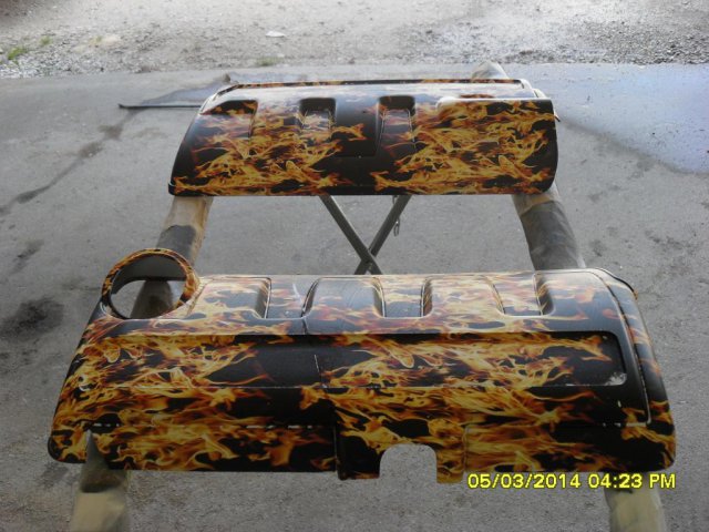

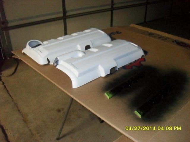

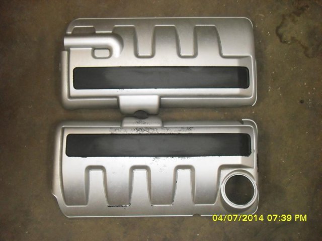

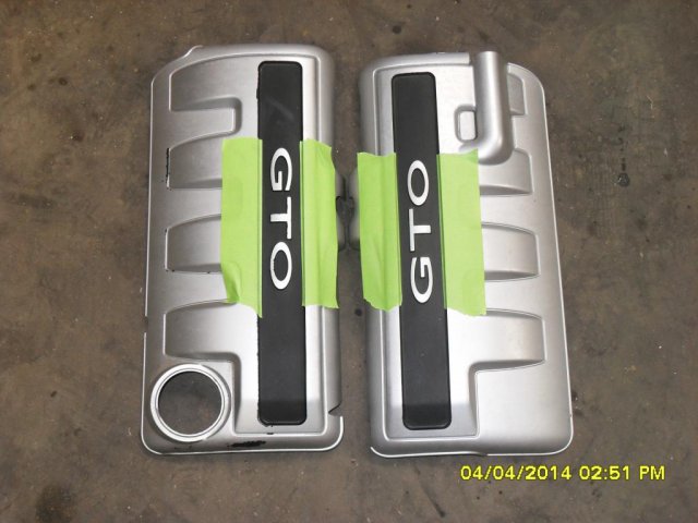

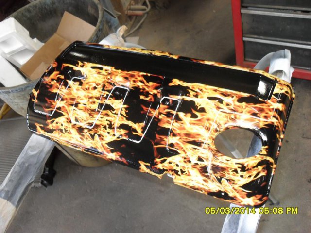

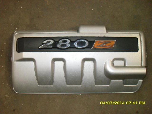

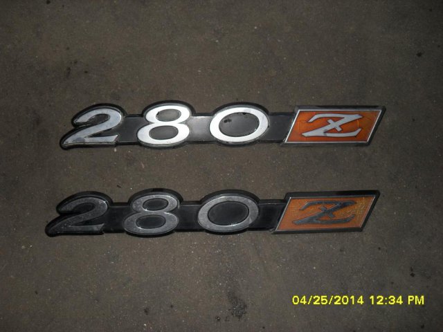

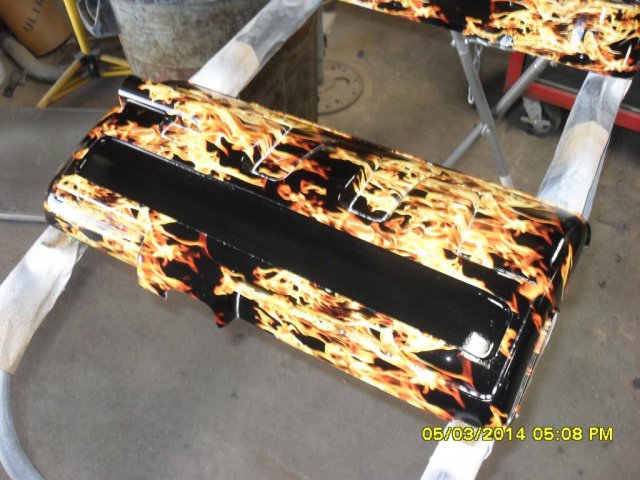

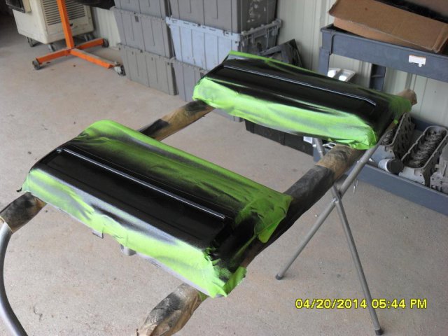

Domzs Posted May 3, 2014 Share Posted May 3, 2014 Got theses covers from a HybridZ member , SOCOROB . Overpaid for them . JK Before . As you can see , he didn't even bother to paint them before shipping . JK Removed " GTO " logo . Painted black . Playing around with " 280Z " fender emblem . Trimmed to fit my setup . White base coat . Almost done , still waiting for " 280Z " fender emblems . Quote Link to comment Share on other sites More sharing options...
OldAndyAndTheSea Posted May 4, 2014 Share Posted May 4, 2014 This is definitely on my list of things to try next. Awesome! How durable is the finish? And I love the 280z emblem. That'll really make it look nice. Quote Link to comment Share on other sites More sharing options...
Domzs Posted May 4, 2014 Author Share Posted May 4, 2014 This is definitely on my list of things to try next. Awesome! How durable is the finish? And I love the 280z emblem. That'll really make it look nice. Thanks . Only time will tell . Have seen people dipped valve covers and oil pans , which are subjected to more heat than my coil covers . A little tricky to do , it takes practice . Hopefully , my next set will turn out a little better . Quote Link to comment Share on other sites More sharing options...

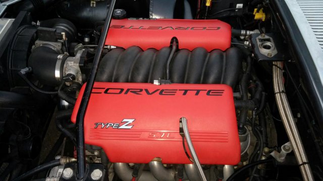

PLATA Posted May 5, 2014 Share Posted May 5, 2014 Nice touch, I did something similar to mine >>> Quote Link to comment Share on other sites More sharing options...

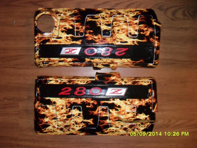

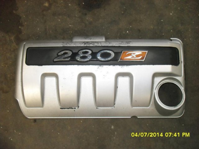

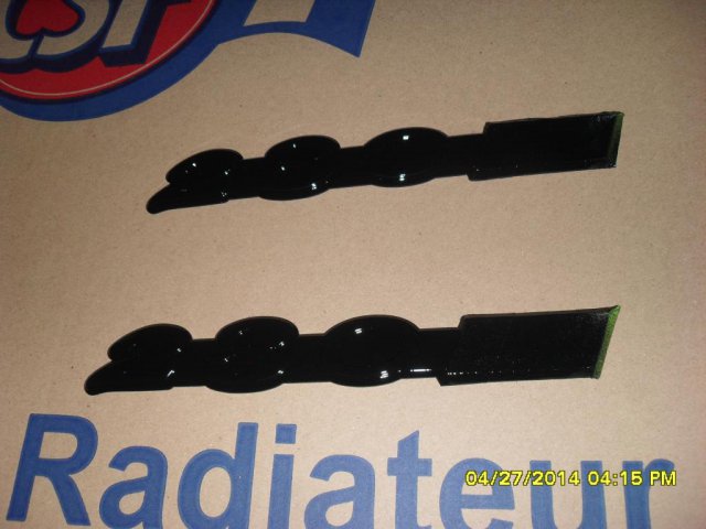

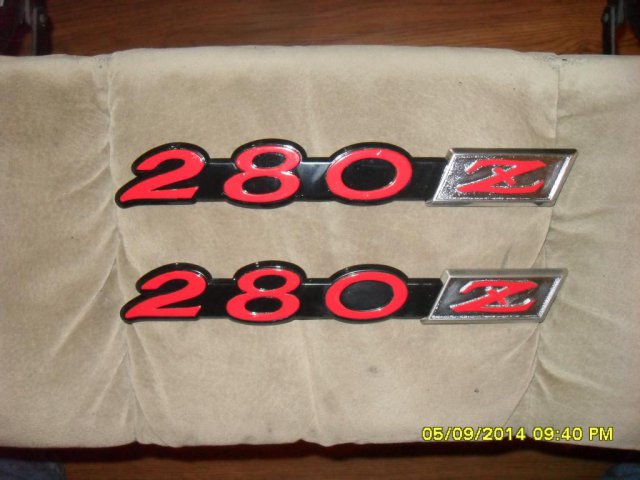

Domzs Posted May 10, 2014 Author Share Posted May 10, 2014 (edited) Here are the " 280Z " fender emblems . Before . Purchased from a HybridZ member , GRNSKY , at a great price . Great seller . After . Covers with emblems . Will have some more pictures of them on the motor soon . Edited May 10, 2014 by Domzs Quote Link to comment Share on other sites More sharing options...
PLATA Posted May 10, 2014 Share Posted May 10, 2014 Can you share how you got that clean red/black/silver look on the side emblems . Quote Link to comment Share on other sites More sharing options...
Domzs Posted May 10, 2014 Author Share Posted May 10, 2014 Can you share how you got that clean red/black/silver look on the side emblems . Actually, pretty easy . I used Scotch brite pad ( brown ) to remove the old paint , down to the chrome . Taped up and sprayed gloss black . Put on red vinyl then trimmed out the " 280Z " . 1 Quote Link to comment Share on other sites More sharing options...

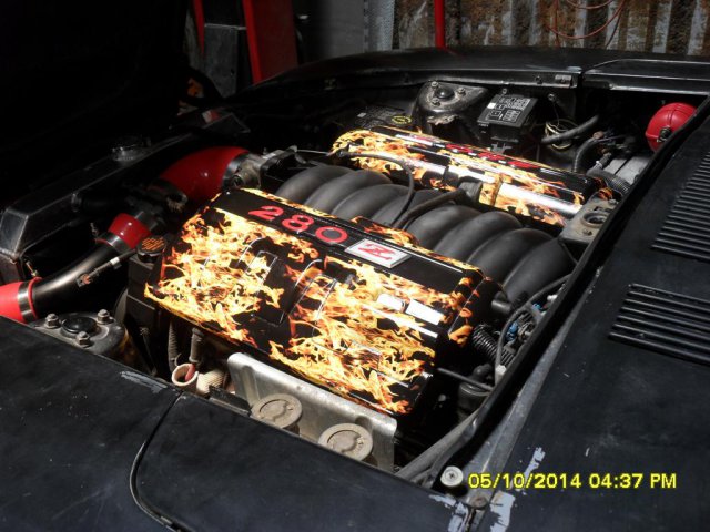

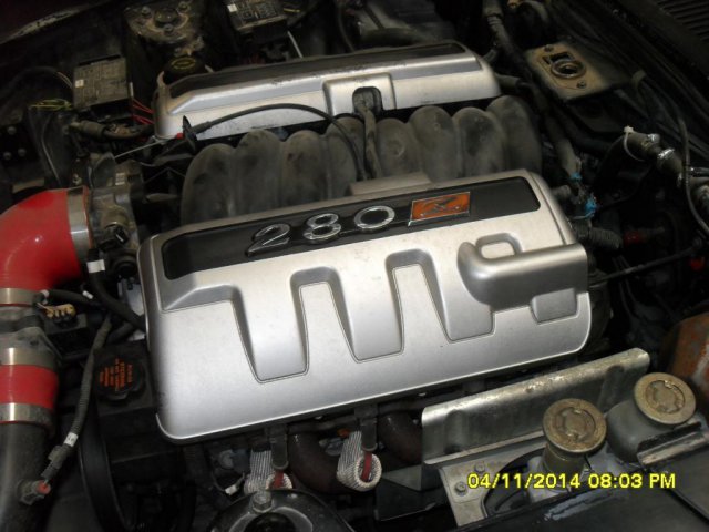

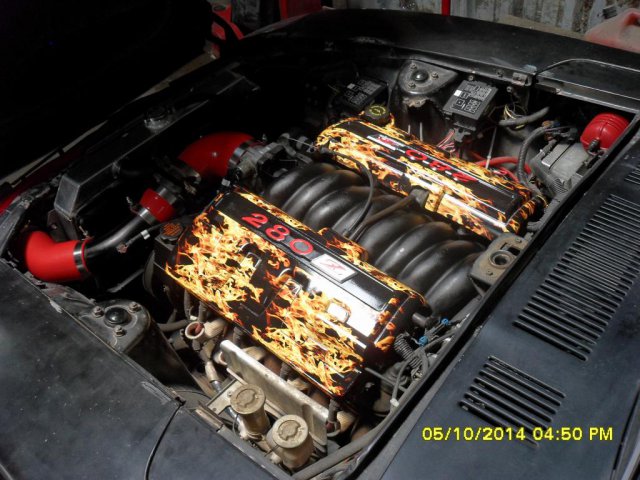

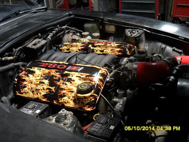

Domzs Posted May 10, 2014 Author Share Posted May 10, 2014 Covers on motor . I might have to pull the motor and do some detail work in the engine compartment , maybe later . . Wonder if I have to do something with intake to complement the coil covers . Quote Link to comment Share on other sites More sharing options...
