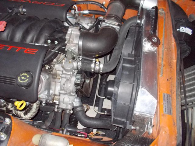

alainburon Posted May 6, 2015 Share Posted May 6, 2015 Why not use all LS1 accessories including the water pump and alternator and be done with it. No spacers needed. Quote Link to comment Share on other sites More sharing options...

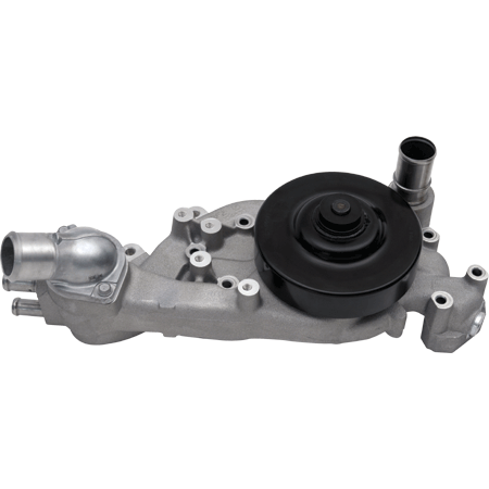

mistafosta Posted May 6, 2015 Share Posted May 6, 2015 Why not use all LS1 accessories including the water pump and alternator and be done with it. No spacers needed. I use the ls3 water pump with spacers cause it gives me 2+" more space for my turbo. He was asking how to adapt the ls3 wp, so I gave him the info on how I did it. Quote Link to comment Share on other sites More sharing options...
alainburon Posted May 6, 2015 Share Posted May 6, 2015 Got it, makes sense, the LS3 pump is shorter than the LS1 pump. If clearance is not his concern I would send that LS3 pump back and get and LS1 pump. My LS3 motor has all LS1 accessories and they line up perfectly without any issues. Quote Link to comment Share on other sites More sharing options...
B5BiTurbo Posted May 7, 2015 Author Share Posted May 7, 2015 I'd love to be able to send it back, but when I bought the crate engine this is what I got with it. Just trying to spend the least amount of money to get things working. A spacer seemed cheaper than buying a new water pump. I'll have a look at the pump when I get home to see of it's the same as that. They all look so similar lol. Thanks again for the info, So should I go with the 2004 corvette tensioner or just get a 2000 camaro tensioner? Thanks again everyone. Quote Link to comment Share on other sites More sharing options...

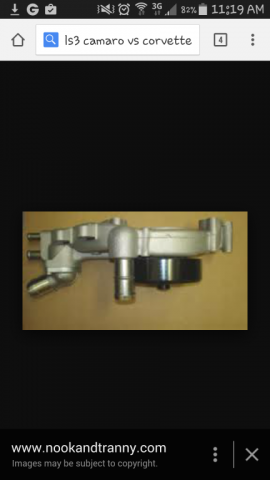

B5BiTurbo Posted May 7, 2015 Author Share Posted May 7, 2015 Oh trust me I know the pan is way to shallow. Just pushing it out of my garage, which has VERY little slope I crushed my oil filter. My car is DUMPED. If LS2 pan can't be taken off with JCI mounts that makes my decision a lot easier. Ok, so I get a corvette tensioner due to the shape of my water pump? And just to reconfirm.. I want a 2004 corvette (z06 or base) tensioner? This will clear my LS3 water pump and give me LS1 spacing? Now I just need to get a picture of my water pump so you guys can confirm if those spacers will work for me. I feel like I'm making some progress with your guys' help. My project went stagnant for a while, but with your guidance I'm getting some motivaton to get back at it. THANK YOU ALL!! Quote Link to comment Share on other sites More sharing options...
B5BiTurbo Posted May 7, 2015 Author Share Posted May 7, 2015 Sorry for the barrage of questions today, but like I said earlier I'm excited about my car again and want to get shit done! I've got a friend of a friend with a 2001 LS1 camaro who just bought a new water pump for his car. If I traded him the one off my car, this one would just bolt right on and give me the correct spacing? Also if I get his water pump does that mean I could also just buy an LS1 camaro tensioner? This route seems like it would be a good bit cheaper for me! Quote Link to comment Share on other sites More sharing options...
mistafosta Posted May 7, 2015 Share Posted May 7, 2015 Sorry for the barrage of questions today, but like I said earlier I'm excited about my car again and want to get shit done! I've got a friend of a friend with a 2001 LS1 camaro who just bought a new water pump for his car. If I traded him the one off my car, this one would just bolt right on and give me the correct spacing? Also if I get his water pump does that mean I could also just buy an LS1 camaro tensioner? This route seems like it would be a good bit cheaper for me! Correct! If you don't need space and have an ls1 pump available, go for it. Then you can just use an ls1 camaro tensioner. If you want a new pump my friend sells them for $65 plus shipping, but I don't know how good that price is. (It's Chinese, but good quality) If you keep the short water pump, any corvette tensioner will work, ls1 or 6 Quote Link to comment Share on other sites More sharing options...
