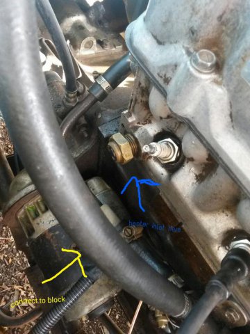

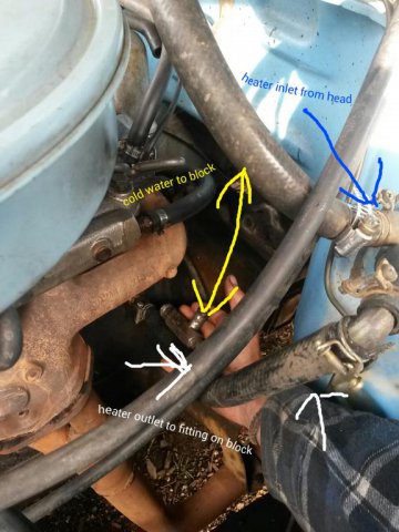

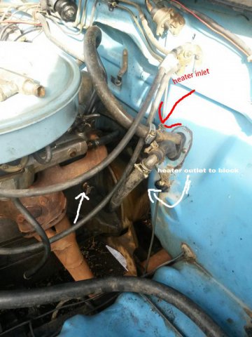

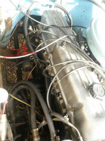

grahamap Posted May 21, 2014 Share Posted May 21, 2014 I know this is a z forum however I havent had any response from the patrol forums. Basically I have an l28 block and e30 head in an mq patrol and im wanting to hook up the heater. Basically im trying to find the best way to run the hoses so I get good heat and my engine gets suffcient cooling. I have labelled pictures of my setup but not sure how to post. Basically from the water pump cool water runa down left side of block, from a t piece a hose goes over the back of the head and connects into the right side of block. The other part of the t piece continues on around the lower part of the block and up into the manifold then at the othet end of manifold connects into thermostat housing. My current setup to involve the heaters saw me taking the longer hose from the t piece and using that for heater inlet. The heater outlet then connected to the right side of the block.. same as before just with a heater core added.. problems with this is the heat isnt that warm and ive seen a raise in temp from engine and that has me worried.. any info or pictures would be great cheers guys, if someome shows me how I can add pictures to better explain Quote Link to comment Share on other sites More sharing options...

grahamap Posted May 22, 2014 Author Share Posted May 22, 2014 this is current setup.. this is what I thought might allow for quicker heating of heater core and better cooling for engine... what do you think Quote Link to comment Share on other sites More sharing options...
blue72 Posted May 22, 2014 Share Posted May 22, 2014 (edited) Hot water should be pulled out of either the block port (currently labeled as "heater outlet to block") or cylinder head and then returned to the water pump. In the US, the hot water was pulled out of the cylinder head (currently labeled "heater inlet here"), but the block port works too. How yours is currently set up, it is pulling hot water out of the block, passing it through the heater core, then returning it to a tee fitting that is returning the water back to your water pump via the external bypass. The reverse of how you have it labeled. Switching your hoses on the heater inlet/outlet might help increase flow. Coolant goes through your intake manifold to warm it up on cold days an prevent icing. From there a line comes out the back of your intake manifold, tees with the water coming from the heater, and returns to the water pump, acting as an external bypass to help prevent cavitation before the thermostat opens. If you tried to route it by pulling water out of the head, and putting it back in the block, then it would probably mostly sit stagnant. Pulling it out of the block, or head, then letting it route back to the external bypass is the OEM way it was done and should flow pretty well. Edited May 22, 2014 by blue72 Quote Link to comment Share on other sites More sharing options...
