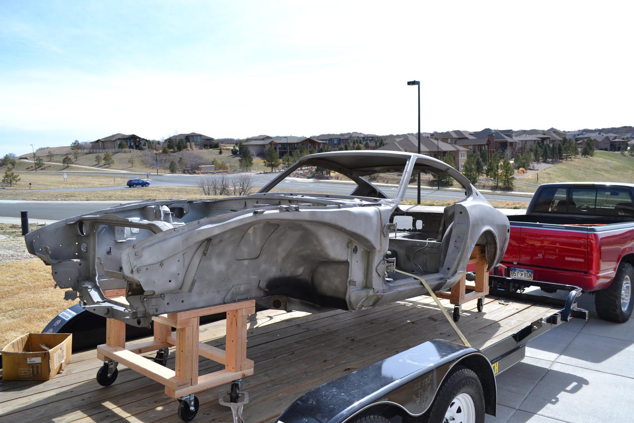

Now shes ready to go to the media blaster.
She looked pretty pathetic when I left her there so I took a quick pic.

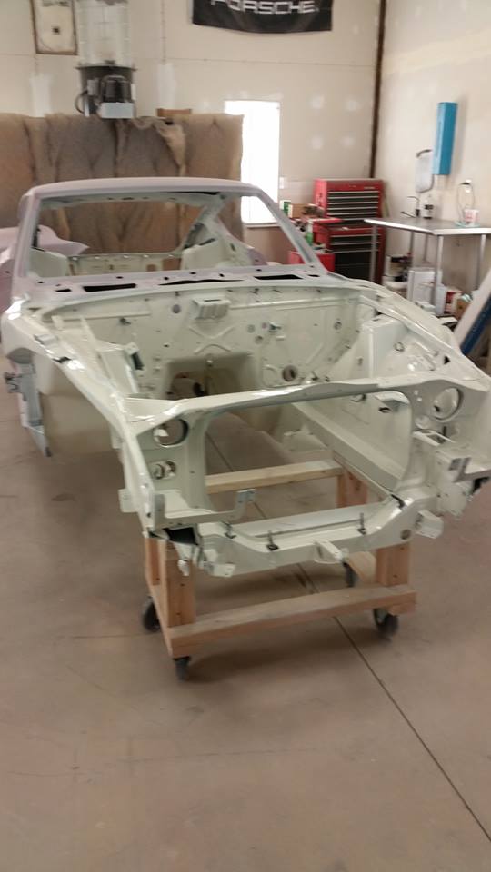

With all the welding done I built a couple make shift carts so I would be able to roll thee chassis around.

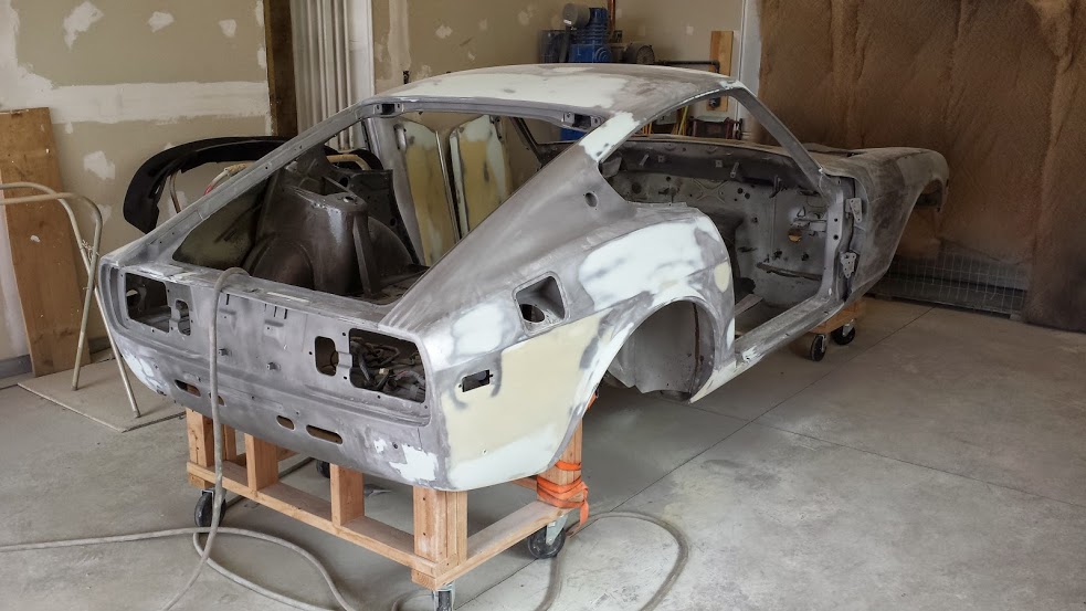

Some body work shots.

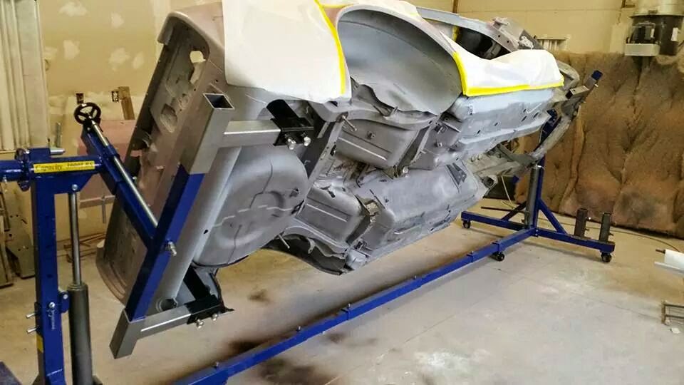

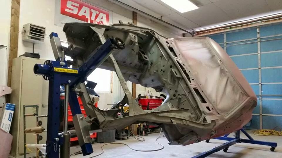

Up on the rotisserie.

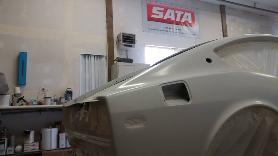

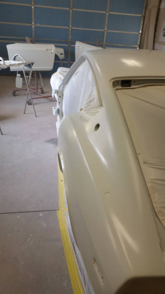

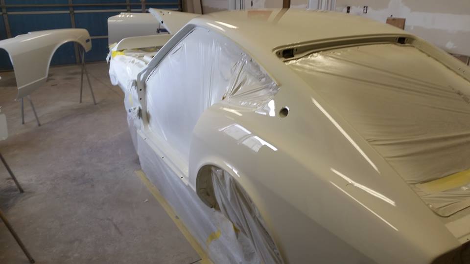

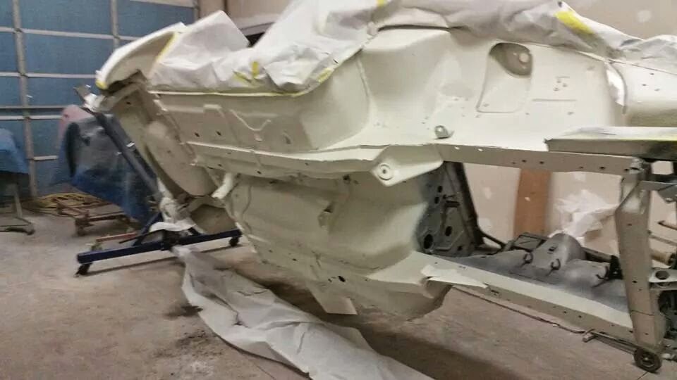

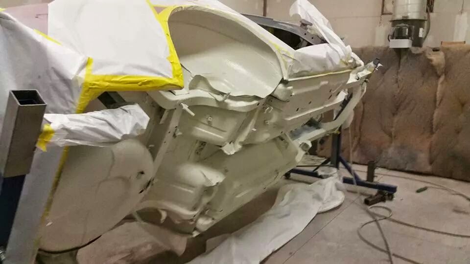

Finally some paint! The car will be painted 904 Ivory base coat/clear coat. The undercarriage was primered and coated with a color matched 3M undercoating.
Base coat only
And thats about where I am at as of now. He was going to deliver the car today but we are getting a nasty storm here in Colorado so it might have to wait until next weekend. He is going to do some more wet sanding and polishing and it should be good to go. I cant wait to see it!

 Got the car back from paint and it looks amazing! He did an awesome job. No orange peel and it was wet sanded and polished to a beautiful shine. It feels really good to have it back, now i'm really excited to get this thing put back together.
