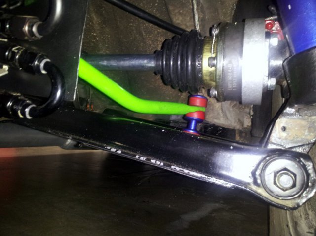

I was thinking of going long with my end links , but I like how yours are so short ...that would make my sway bar clear ...still need to road test under hard acceleration to make sure the control arm is for sure free and clear

Sorry, I could not see where he was rubbing.  I clear just fine on the inside and outside.   I am running an R200 (3.70 CLSD).
I should point out as well that since I was already lowered using the Tokico springs and struts (280z springs cut), by shortening the sway bar endlink the end is now parallel to the ground.
Edited by ktm
I took a closer look at your picture as well as my setup.  I am a bit closer than I originally stated only because I misunderstood where you were rubbing.  Are you sure that the stub shaft(s) is(are) fully seated in the R200?
Yes they are as far in as they can go ...alignment groove is even all the way around , I put some paint on the cv joint where it was rubbing , I'll check it after the next road test , sway bar has gotta go , it's irritated me enough
