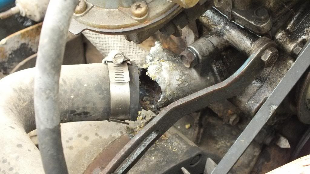

Welp, here's the deal. Bought my 240Z with 6 holes in the original radiator, and replaced it with a two row aluminum radiator that i bought off of Ebay new after i got the car running.

Oh, and the P.O Ran straight water in the system... Had to replace the water pump inlet because it dissolved due to this.

If the previous owner ran water in the system, what have you done to clean the system?  Do you know if they used tap water or distilled?  It only takes a few weeks for a new radiator to get mineralized and quit working if installed in a contaminated system.
In my experience retarded timing will make the engine run cooler, but the exhaust system much hotter.
All i have done to clean the system is basically let the water drain out of everything. The heater lines are all disconnected/plugged, so i didnt bother with the heater core. I have no idea what form of water they used in the engine, but whatever they used caused this:
Edited by Connor280ZX
You have a heavily corroded / contaminated system.  Until you fix that, the car will overheat regardless of what radiator, fan or shrouding is on there.
As of now, your block has a lot of rust scale in it, and the aluminum parts are covered in aluminum oxide.  The white stuff in the picture is aluminum oxide.  A surface that is corroded is less efficient at transferring heat than a clean surface.
Oh great, i had a feeling... I hope i haven't done too much damage to my new Rad, probably have less than 30 miles on it. I'm sending the car in tomorrow to get brake work done, could i trust the shop to perform this whole cooling system flush procedure while the car is there?
Depends on the shop, but most shops I would not trust to understand what's going on inside.  It will be labor intensive.  Either invest the time and a few dollars doing it yourself, or a lot of money to have someone else do it.  If you decide to do it yourself, have the shop drain the coolant from the entire system.  All the chemicals used are environmentally safe, so disposal is easy.  The cleaners to do this are less that 50$, but the labor should be in the ball park of 3-400 if the shop intends to do a good job an still make a bit of money.
A few weeks will not permanently hurt the radiator.  Once it goes through the cleaning cycles it will be fine.  It's not rocket science, just basic chemistry.
