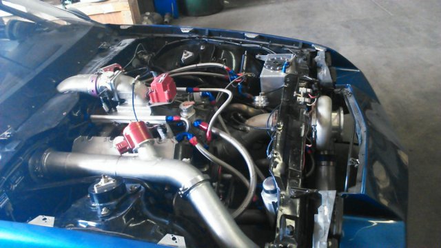

hwvigo Posted June 17, 2014 Share Posted June 17, 2014 (edited) Neal chance racing makes top notch converters. I have worked in there place fixing there band saw they are super nice and you can order direct from them. Not to mention they build some nice cars and they only work half days Fridays so they can get all there cars ready for the races. http://www.racingconverters.com/ncrc/ not a great pic of one of their camaros . Edited June 17, 2014 by hwvigo Quote Link to comment Share on other sites More sharing options...
