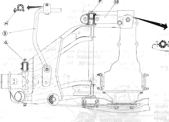

Miles Posted July 4, 2014 Share Posted July 4, 2014 (edited) The R200 mustache bar should look like the attached picture when installed correctly. Edited July 5, 2014 by Miles Quote Link to comment Share on other sites More sharing options...
thomas461 Posted July 4, 2014 Author Share Posted July 4, 2014 Miles I think that picture may have helped me. All the pictures show the bushings toward the rear of the car. Your shows it forward with the bar behind the dog legs. Quote Link to comment Share on other sites More sharing options...

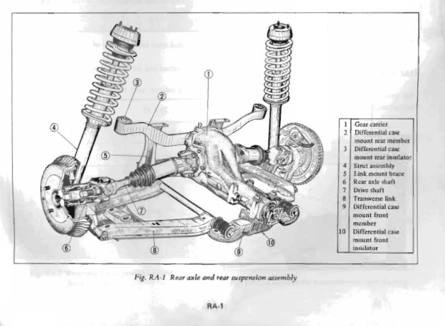

NewZed Posted July 4, 2014 Share Posted July 4, 2014 (edited) Here's another, same idea. 1975. You must be looking at early Z R180 pictures. Attached a 1973 picture for ref. Edited July 4, 2014 by NewZed Quote Link to comment Share on other sites More sharing options...
thomas461 Posted July 4, 2014 Author Share Posted July 4, 2014 That was it. I was looking at the 260Z trying to figure out why the darn thing wouldn't work. Thank you both for the assistance. The diff is in. https://www.flickr.com/photos/my260z/14551577396/ Pete Quote Link to comment Share on other sites More sharing options...
