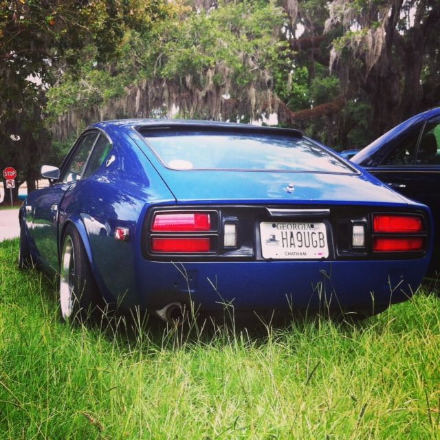

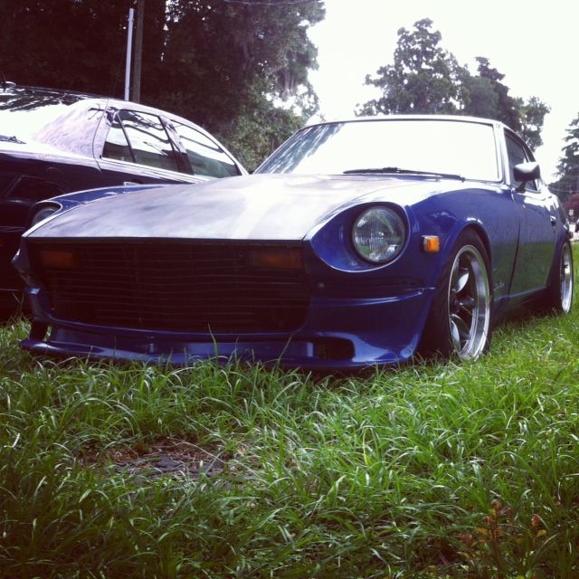

Dat260Z Posted July 25, 2014 Share Posted July 25, 2014 (edited) Here are my 16x8 +4 with 205/50/16. Running a 7mm spacer in rear to clear brakes Edited July 25, 2014 by Dat260Z Quote Link to comment Share on other sites More sharing options...
lorenzo Posted July 25, 2014 Author Share Posted July 25, 2014 Here are my 16x8 +4 with 205/50/16. Running a 7mm spacer in rear to clear brakes Looks nice, great stance! You car looks pretty low. I wish the style wheels I purchased came in 16 inch because of the tire selection Quote Link to comment Share on other sites More sharing options...
