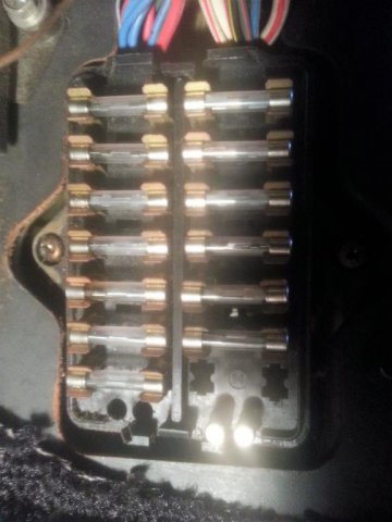

I have been away from the car for a bit and it is still not charging correctly. I do not have a Floor Temp fuse in my car, that slot is empty. -
