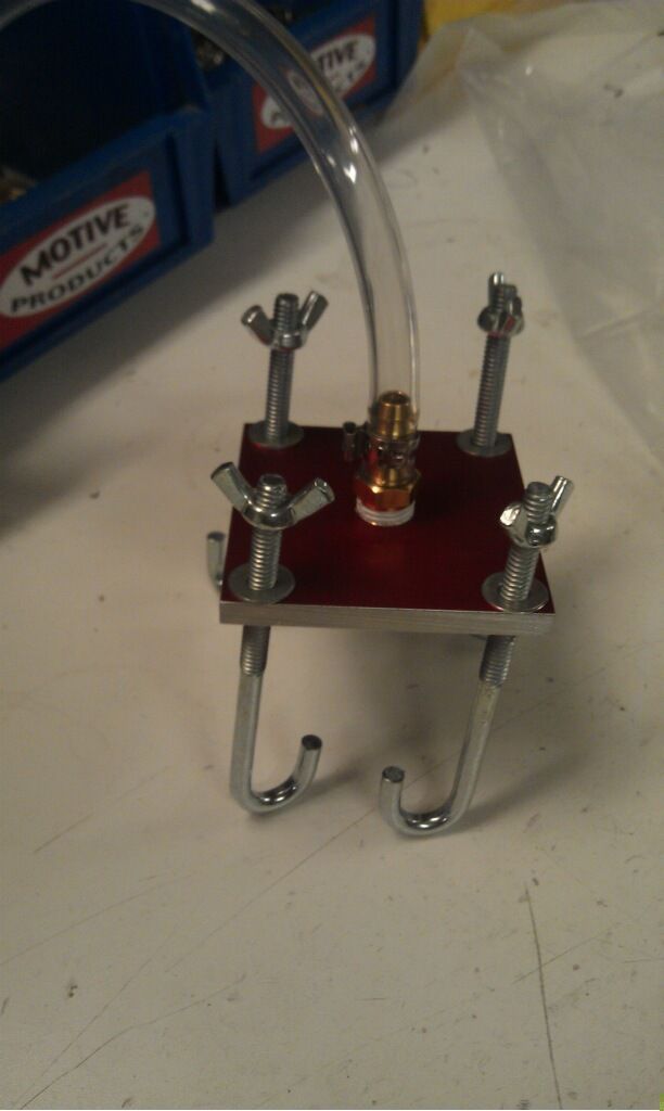

thezguy Posted August 19, 2014 Author Share Posted August 19, 2014 Thanks for the responses. Guys this is the specific "universal" adapter that motive sells for our "small bore" reservoirs. The co-owner Eric said he maid these specifically for the 240/260/280 and other small 2 tabbed reservoirs. Quote Link to comment Share on other sites More sharing options...
