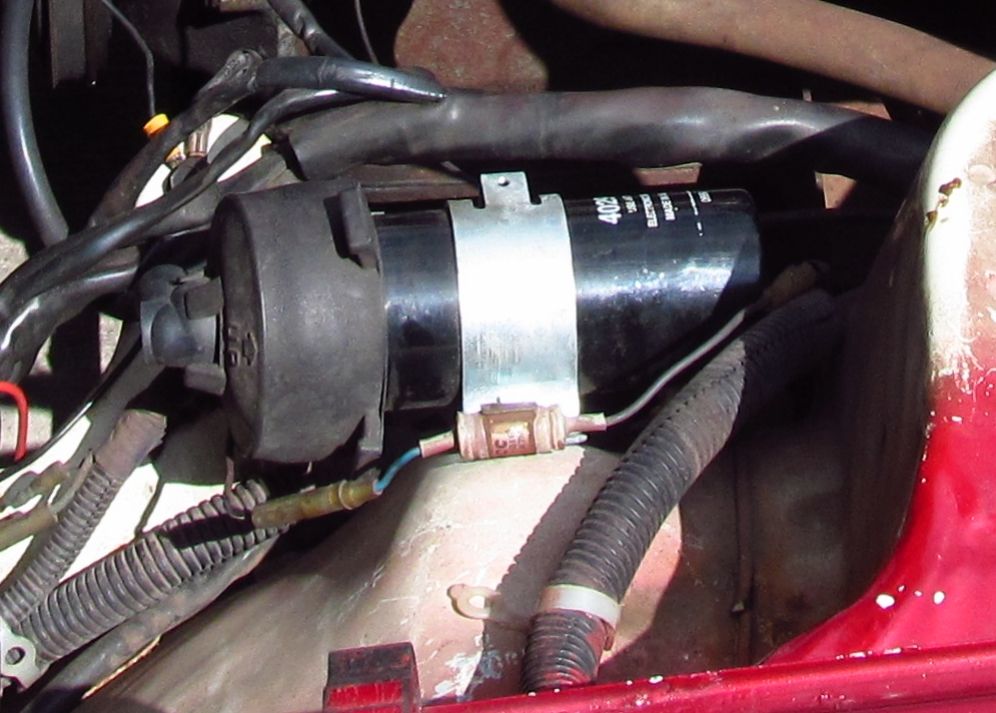

japscrap Posted October 20, 2014 Author Share Posted October 20, 2014 (edited) I will shoot a video for you all, in the mean time here goes a picture of what I replaced on the ignition coil.it is the little white ceramic resistor?? that is in the middle of the ignition coil strap. Edited October 20, 2014 by japscrap Quote Link to comment Share on other sites More sharing options...
NewZed Posted October 20, 2014 Share Posted October 20, 2014 If you mean the thing I circled in red, that's a capacitor, aka condenser. They do go bad occasionally. I see no ceramic pieces. The miss on the condenser makes one wonder what you meant by ignition control module. The coil looks stock. Might be worthwhile to browse through the FSM, Engine Electrical, and make sure you're getting the names right, at least. There are some parts on the ZX type distributors that can break after many miles. Quote Link to comment Share on other sites More sharing options...
