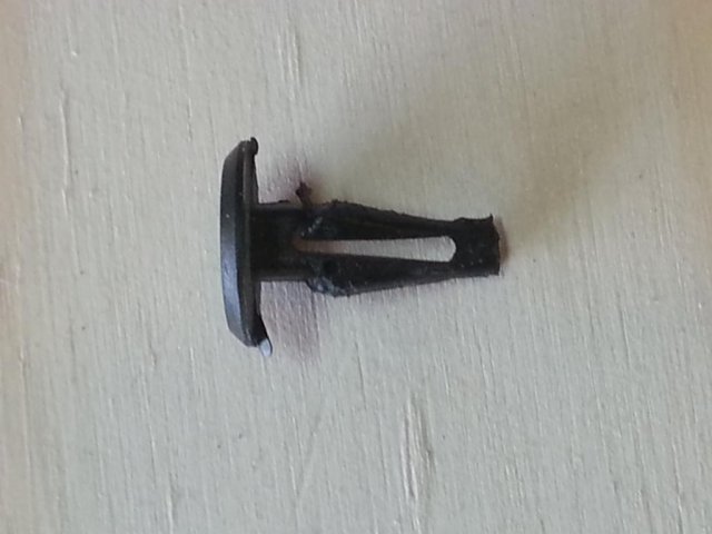

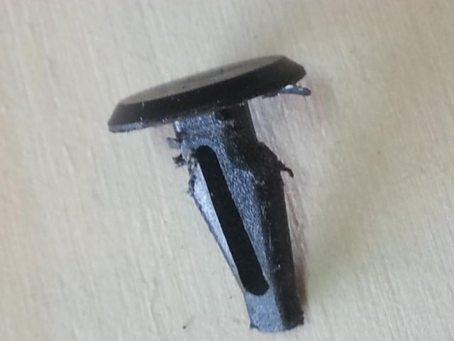

Milenko2121 Posted October 28, 2014 Share Posted October 28, 2014 I recently re did my interior and had to get new rivets. I refuse to pay near a $1 for a small piece of plastic so I did some searching and found a replacement rivet. I had seen an old post on another forum(forgot which) and a user used these on his Z. I bought them last week and they just got here today. They fit almost perfectly, they just require a little persuasion by tapping them in gently with a hammer. FORD FENDER SHIELD PUSH TYPE RETAINERS OEM 387843-S I got 50 of them for $12 including shipping over on ebay. http://www.ebay.com/itm/260774018886?_trksid=p2059210.m2749.l2649&ssPageName=STRK%3AMEBIDX%3AIT Figured i'd put this here for someone else in the future searching for a rivet replacement and doesn't want to spend almost a $1 on a single rivet. Quote Link to comment Share on other sites More sharing options...

drdiabetezx66x Posted January 4, 2015 Share Posted January 4, 2015 So the McMaster push pin clips were to small. The Christmas tree style fit much better. The head was to small on the pushpins. I'm going to see if I can find some with a larger head. The top one is the stock one, middle is McMaster pushpin and bottom is Christmas tree style (1st image). 2nd image starts with the stock one on right. You can see the difference. Quote Link to comment Share on other sites More sharing options...
drdiabetezx66x Posted January 4, 2015 Share Posted January 4, 2015 Pictures are messed up. Stock one is on bottom of first pic and right of 2nd. Quote Link to comment Share on other sites More sharing options...
