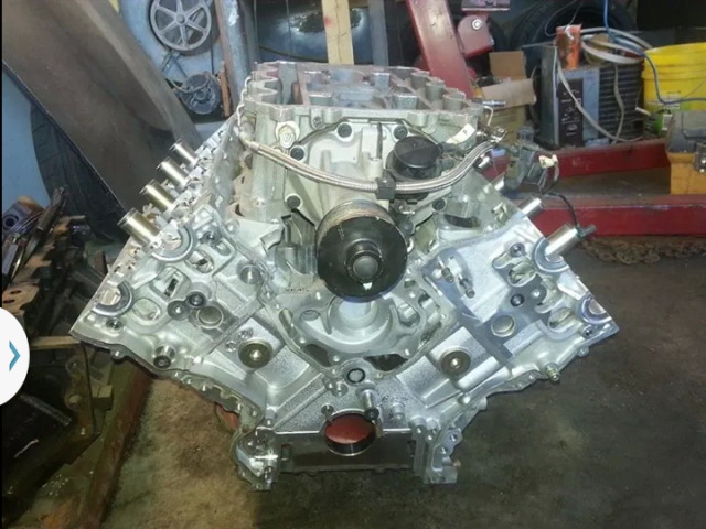

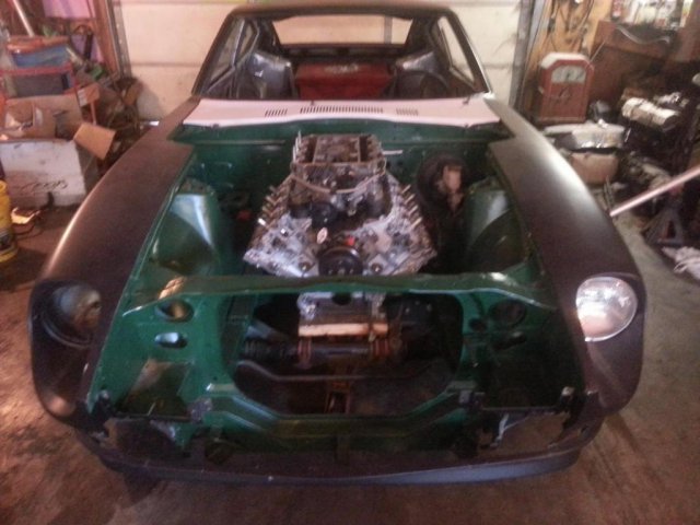

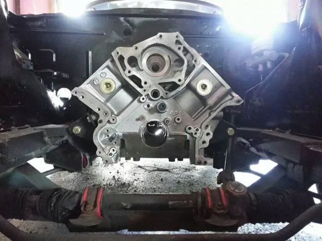

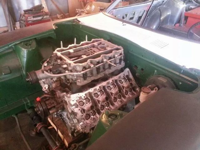

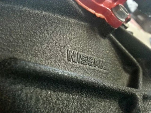

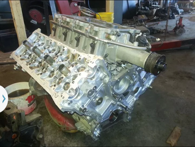

SidewaysC Posted November 21, 2014 Share Posted November 21, 2014 I could've sworn I had already started this thread, buts it's been...awhile...so who knows. I've got a Z I've been working on for a while now, but as with most things funds are low and progress is slow. So far I have motor mounts fabbed up, as well as a rear strut bar. Will be picking up various flanges and such from the waterjet pretty soon to start fab for supercharger mounting, as well as a new oil pan as the Q45 pan is a front sump Pictures! Quote Link to comment Share on other sites More sharing options...
Boben Posted November 26, 2014 Share Posted November 26, 2014 Nice work there man! What transmission are you going to be using? have you checked the clearance to the top of the transmission tunnel with the engine mounted as you have it? I am just wondering because I am doing something similar, but with a BMW M62 engine combined with a Getrag 420G. If I want to leave the tunnel untouched, the engine needs to be mounted quite low. Quote Link to comment Share on other sites More sharing options...
SidewaysC Posted November 28, 2014 Author Share Posted November 28, 2014 Plan on sticking either a T56 or W158 behind it, but havn't had the funds to get either yet. Had a sbc/t350 in it before with no clearance problems. Honestly havn't really even thought about it. Bare interior car, so I'm not afraid to modify as needed. Quote Link to comment Share on other sites More sharing options...

1969honda Posted July 21, 2016 Share Posted July 21, 2016 Very interested to see where this goes, is that the Cadillac m122 in the pervious pictures? I have a 2012 GT500 M122 in the garage that I'm *slowly* working on getting adapter to a vk56. Quote Link to comment Share on other sites More sharing options...

SidewaysC Posted July 21, 2016 Author Share Posted July 21, 2016 Yeah, it is. But I don't have the case anymore, and it was honestly proving itself to be more trouble than its worth. The heads are staggered opposite of most V8s on northstars, so the ports were going to be way out of alignment. I was going to end up shaving all the intake stuff off of it and starting from just a supercharger. I'll probably just stick with a GT500 unit this time around. Moar monies, but less hassle Quote Link to comment Share on other sites More sharing options...
