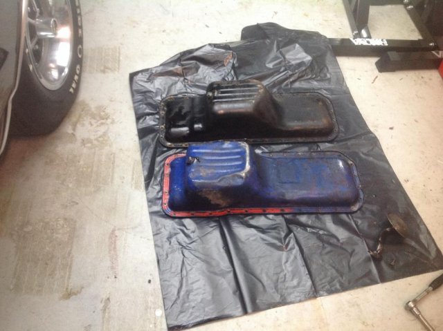

Project1 Posted February 9, 2015 Share Posted February 9, 2015 (edited) I just had to make the same decision. I went for the ZX na oil pan. Works great, but you need to change the pick up/sump as well as the pan. The ZX pick is longer because the drop in the oil pan is farther back. Edit: disregard the abuse to the pans, their a little beat up. It's how my z rolls .... Or ..well.. Sits in the driveway Edited February 10, 2015 by Project1 Quote Link to comment Share on other sites More sharing options...
