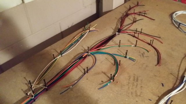

nickbenjones Posted March 1, 2015 Share Posted March 1, 2015 So I've fabricated a new EFI wiring harness because the PO decided to splice every wire and tape it back together.... needless to say the rest of the connectors were rotted, and the contacts were completely corroded. I'm trying to source high temp shielding for the wiring. the oem shielding was pvc however id prefer a high temp braid as a solution. Any Ideas? Quote Link to comment Share on other sites More sharing options...
