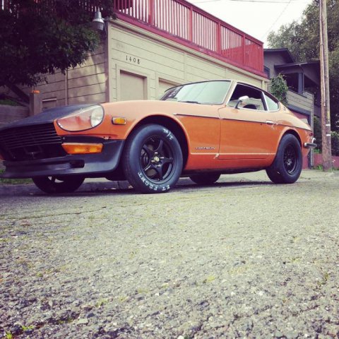

My drag wheel/tire set up.
I thought Id share my current set up with you guys. I wanted something different, not the typical welds or cragers and I also wanted to keep it 4 lug. Milling is required of wheel hub and spacers for the fronts to fit. The Lenso hub is 56.0mm, I had it opened to 62.0mm and the spacer opened to 73.0mm. Next purchase is a set of T3 bolt in camber plates so I can lower the car and increase the strut travel, but this is because I am running non-sectioned strut housings. Something different, I realize it might not be everyone's cup of tea but the information is out there now for anybody else to copy.

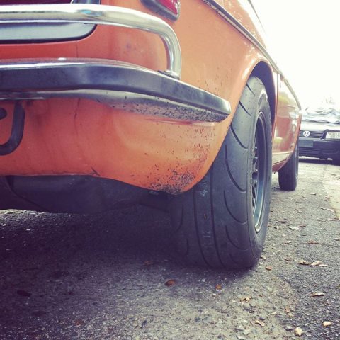

Rears
235/60/15 M/t ET Streets
XXR 531 15x8 et20
ARP 2.5" M12x1.5 Studs
T3/GC coilovers on non-sectioned struts
Tokico 5-Ways, 10" 225 springs
Fronts
24" 15x4.5 ET Fronts
Lenso VPD 15x3.5
1" spacer
ARP 3.0" M12x1.5 Studs (2.5" would be fine)
