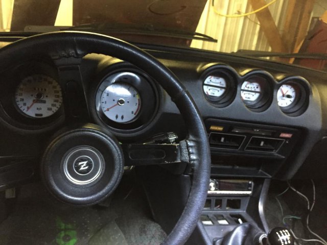

Phantom Posted May 28, 2015 Author Share Posted May 28, 2015 PROGRESS!! Dash and new console are back in. Other progress too but that is for a later update. Quote Link to comment Share on other sites More sharing options...

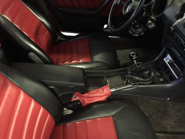

alainburon Posted May 28, 2015 Share Posted May 28, 2015 Nice clean looking interior. Quote Link to comment Share on other sites More sharing options...
Phantom Posted May 28, 2015 Author Share Posted May 28, 2015 Thank you. It's actually pretty filthy right now but it still looks pretty good after 10 years and nearly 100,000 miles. When I redo the exterior the interior is going to be untouched. Way too expensive to try to change it. Quote Link to comment Share on other sites More sharing options...
