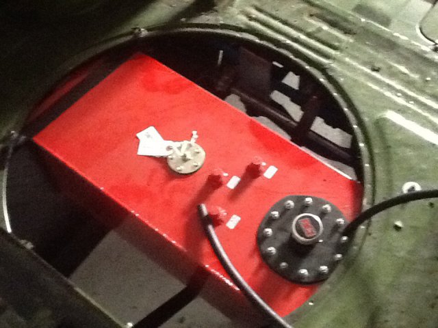

12doplumbing Posted April 3, 2015 Author Share Posted April 3, 2015 I just pm'ed Tony D on this -- man, there are a few threads talking about the heat and vapor causing cavitation, etc., especially when fuel level is low. These questions have me really questioning my set up; no more stock tank, fuel cell, new feed and return rigid 3/8 inch lines, a rollover vent... The pressure I'll need is 40psi constant for the turbo L28? So the inline pump I want has to deliver enough volume and pressure, and then needs to be regulated at 40... How to plumb this? Where is the regulator? Do I need a charcoal cannister? Cavitation issues worry me, pressure loss worries me, I'm a regular cluster__ of questions now! Quote Link to comment Share on other sites More sharing options...
skirkland1980 Posted April 3, 2015 Share Posted April 3, 2015 I'd go with an in-tank pump. The walbro 255 is also available in an in-tank version. Cavitation then shouldn't be an issue. Quote Link to comment Share on other sites More sharing options...
12doplumbing Posted April 3, 2015 Author Share Posted April 3, 2015 Makes sense. Hopefully this fuel cell from Jegs will allow this option easily.... Thanks for the reply. 1) Submersible/in tank pump, 2) filter 3) regulator set at 40psi 4) connect to rail inlet 5) return from rail to tank Any other items in between I'm not factoring in? Check valves anywhere? Quote Link to comment Share on other sites More sharing options...

12doplumbing Posted April 3, 2015 Author Share Posted April 3, 2015 I think I screwed up; didn't like the cells with pump prices - damn! Pricey; thought I could purchase pump and filter and save @ $400... But the whole cavitation and overheating issue is something I was unaware of. So, now I toss the fuel cell and start searching for an all-in-one unit. Besides, I learned the single wall aluminum cell I was intending to use wasn't sufficient for the application; mounted where stock tank was, exposed, should have a rubber bladder for safety. Thanks for the feedback. Will post replacement system here when I find one. Submersible in-tank pump is the only way to go for these turbo conversions, is what I'm thinking. Quote Link to comment Share on other sites More sharing options...

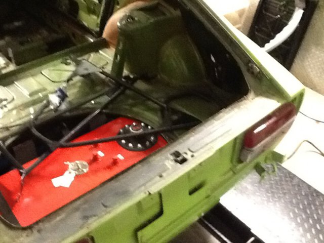

12doplumbing Posted April 3, 2015 Author Share Posted April 3, 2015 We're putting an '83 Turbo into our '72. We read about needing a later model tank to swap in, with a baffle, etc., and knew our fuel lines were insufficient -- bottom line, stock wouldn't work so we got it out of the way. Quote Link to comment Share on other sites More sharing options...

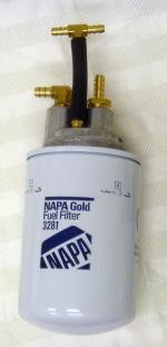

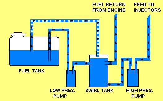

12doplumbing Posted April 4, 2015 Author Share Posted April 4, 2015 New Zed: I guess I couldn't find what I was looking for until you told me to search in this sub-category... That was good reading! I like the BCBroncos solution; small little oil-filter-type swirl tank. But I also like the drilling out/tapping my aluminum fuel cell for an in tank pump -- nobody posted anything after in that 2011 thread. I'll go back and save some images to post now (BCBroncos and the other in-tank) Quote Link to comment Share on other sites More sharing options...
12doplumbing Posted April 4, 2015 Author Share Posted April 4, 2015 This is quite the simple solution, but still requires a whole lot of joints and two pumps (potential for leakage, additional pump...) I think I want to just tap my rci fuel cell and install this: Walbro 255 Then regulate pressure, filter, hook up to my new 3/8 feed and come back in my new 3/8 return. That sound best to you New Zed? Quote Link to comment Share on other sites More sharing options...

12doplumbing Posted April 4, 2015 Author Share Posted April 4, 2015 The fuel cell not being tapped for an in-tank pump was okay with me until i read about overheating fuel, cavitation etc. (we arent running a super high performance motor -- pretty much a stock set up) Reading about how to overcome these potential problems brought me to two options: 1) the external set up; low pressure pump, swirl/surge tank, high pressure pump, reulator, return in minimum 3/8 inch line Or 2) drill out fuel cell for Walbro 255 with tray in-tank pump, filter and regulate externally continuing in 3/8 inch supply to inlet on rail, return to cell in 3/8 inch If the second schematic sounds ideal, i want to do it (actually, i ordered the Walbro last night in anticipation). Looking for the easiest to maintain and troubleshoot system. I already plumbed the new rigid 3/8 inch lines through the tunnel and hung the cell - this pump and return question is really a "What is best to do now?" Query. Quote Link to comment Share on other sites More sharing options...
NewZed Posted April 4, 2015 Share Posted April 4, 2015 Your main concern with an unbaffled 240Z tank should be fuel starvation on corners. If the driver plans to drift it might be an issue. With a turbo engine it's an important issue. Proper baffling or the surge tank will solve that. Submersed pumps tend to be quieter than external. Might be nice. Quote Link to comment Share on other sites More sharing options...
TimZ Posted April 4, 2015 Share Posted April 4, 2015 Your main concern with an unbaffled 240Z tank should be fuel starvation on corners. If the driver plans to drift it might be an issue. With a turbo engine it's an important issue. Proper baffling or the surge tank will solve that. Submersed pumps tend to be quieter than external. Might be nice. ^^^^What NewZed said ^^^^ The cavitation issues really mostly start cropping up when you start trying to flow a LOT more fuel than stock. A single Walbro likely won't have much trouble as long as the tank is properly vented so it doesn't pull a vacuum, and you aren't doing anything dumb like trying to feed it through a 1/4" fuel line or something. If you can get an in-tank setup for your fuel cell then that likely won't hurt anything - just be sure it has some sort of baffling around it as NewZed suggested. Quote Link to comment Share on other sites More sharing options...
