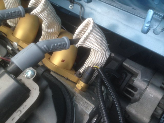

RebekahsZ Posted May 22, 2015 Share Posted May 22, 2015 (edited) MSD with flexible boots. I did dimple one tube. Two years, so far so good. They were on the motor when I bought it. Edited May 22, 2015 by RebekahsZ Quote Link to comment Share on other sites More sharing options...
mistafosta Posted May 23, 2015 Share Posted May 23, 2015 MSD with flexible boots. I did dimple one tube. Two years, so far so good. They were on the motor when I bought it. X2. I made 600-800hp on my setup and created a TON of heat, eventually I had to use the boots to protect them, but the MSDs always worked best for me Quote Link to comment Share on other sites More sharing options...
socorob Posted May 23, 2015 Author Share Posted May 23, 2015 Did y'all use the metal boots the stock ones had on the msd wires? Quote Link to comment Share on other sites More sharing options...
RebekahsZ Posted May 23, 2015 Share Posted May 23, 2015 (edited) No. Let me go snap you a pic of my wires-standby while I go out in to my self-made fiberglass hell. Edited May 23, 2015 by RebekahsZ Quote Link to comment Share on other sites More sharing options...

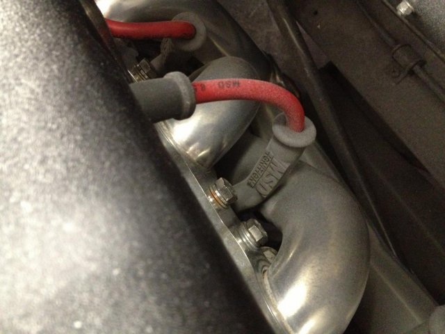

str8pipez Posted May 23, 2015 Share Posted May 23, 2015 (edited) I have been looking at the MSD wires online and saw there were 2 boots. According to the ebay ad, black boots are regular and red boots are hi temp? http://www.ebay.com/itm/MSD-Ignition-32819-32813-spark-plug-wire-set-LS1-LS2-LS3-LS6-LS7-LS9-/151012469582?hash=item23290b6b4e&vxp=mtr Look at the 3rd picture. I originally bought a set of those in red (high heat). I think the guy makes the sets. The wire is MSD, but not the boot or plug at the coil. I threw a misfire DTC. Changed to real MSD's, no more code. Coulda been the luck of the draw but for another $12 you get a set made by MSD. I also added fiberglass sock things at the headers. The annoying brown spot in the photo is the skin from an almond. I can eat enough of them and get almond crumbs on stuff, sorry. Edited May 23, 2015 by str8pipez Quote Link to comment Share on other sites More sharing options...
