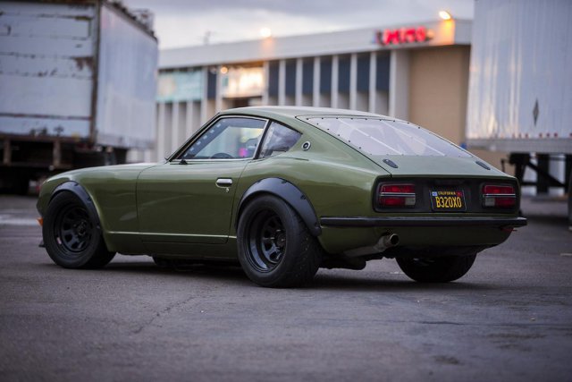

fyanrudger Posted December 20, 2015 Author Share Posted December 20, 2015 (edited) Where have you guys purchased your paint with the paint codes? If I wanted to order a touch up paint in lets say 907 racing green, where or how would I go about that? Looking online it doesn't seem to have any luck with all the colors let alone "safe" sites. I went with TCP Global's Restoration Shop brand to reproduce the Datsun 113 Avocado. Here's the completed car... Edited December 20, 2015 by fyanrudger Quote Link to comment Share on other sites More sharing options...
