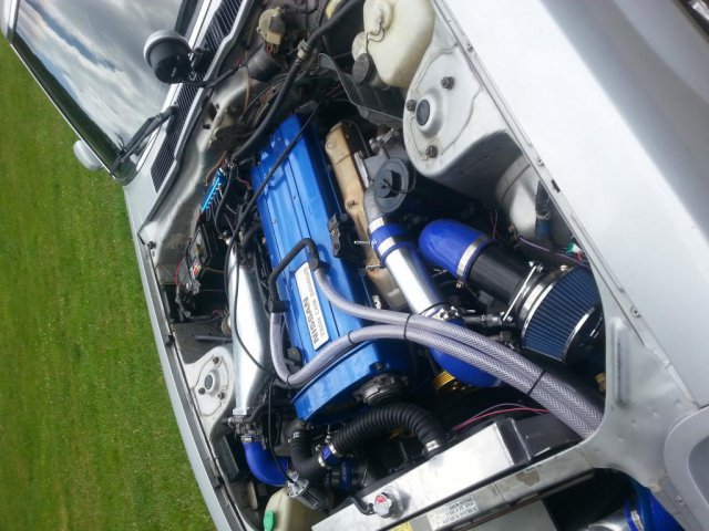

tylerd280zx Posted June 9, 2015 Author Share Posted June 9, 2015 I did away with a few things and added a few hope the pic is clear enough to see mostly what I've done.. . Since the pic I added a fpr....due to my plugs showing really lean. I took it down the road feels sluggish and like I hit a wall at 4k plus I have the idle problem....checked for codes and shows 55 all is OK. I'll check the IAC motor pintle. Quote Link to comment Share on other sites More sharing options...

wrcbonk Posted June 12, 2015 Share Posted June 12, 2015 Tyler, I have an RB25. One time we were messing around with my engine and unplugged the vacuum line from the FPR and then like idiots forgot to plug it back in before running the car. With that vacuum leak, the car idled at 1000 and there was distinct sucking sound under throttle. If the IAC turns out to be fine you might want to start looking around for an unplugged or damaged vacuum line. Bill Quote Link to comment Share on other sites More sharing options...
