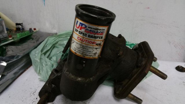

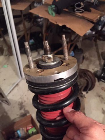

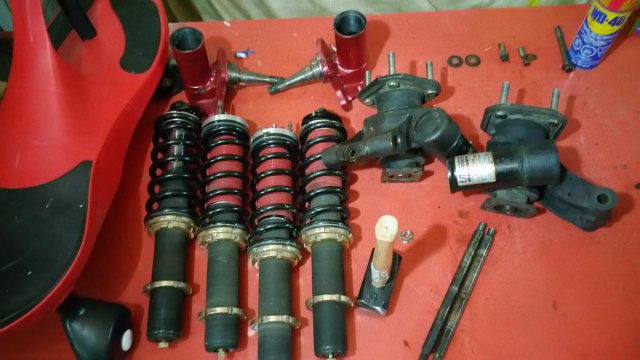

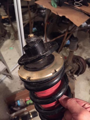

rickyellow zee Posted June 10, 2015 Share Posted June 10, 2015 (edited) I recently bought a set of Up Garage coilovers from a local guy and need some help with getting the final parts for the setup. I was told that they are S13 coilovers welded to 280z spindles. Seems about right. The top hats have me concerned. They appear to be S13 and I guess I need 280z top hats and camber plates to finish off the setup? Not sure though...thats why I ask you fine people to have a look at the pics and chime in on what needs to be done to get this up and running. Pics. Edited June 11, 2015 by rickyellow zee Quote Link to comment Share on other sites More sharing options...

Hypertek Posted June 11, 2015 Share Posted June 11, 2015 For the front, all you need is camber plates. https://technotoytuning.com/nissan/260z/240z-260z-and-280z-cut-and-bolt-camber-plates These might work. For the rear, you can drill 2 holes into the strut tower and bolt them directly. Quote Link to comment Share on other sites More sharing options...
rickyellow zee Posted June 11, 2015 Author Share Posted June 11, 2015 Thanks! The rears I can do but the fronts are beyond my abilities. I dont weld or have the cash for the work. Bolt ins would be best. Quote Link to comment Share on other sites More sharing options...
casper9182 Posted June 12, 2015 Share Posted June 12, 2015 Make your current top hats work. You won't have camber adjustments tho Quote Link to comment Share on other sites More sharing options...
JoeK Posted June 12, 2015 Share Posted June 12, 2015 The link Hypertek sent you is for bolt in camber plates. TTT makes both types. Quote Link to comment Share on other sites More sharing options...
