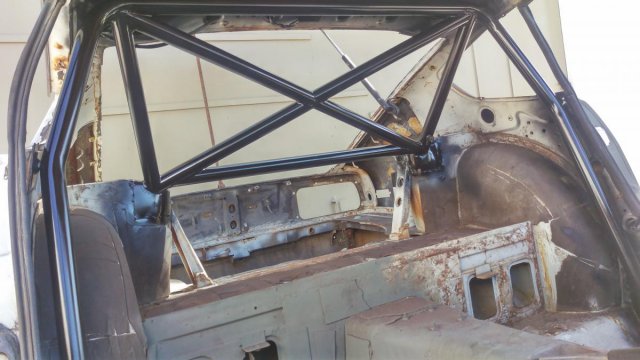

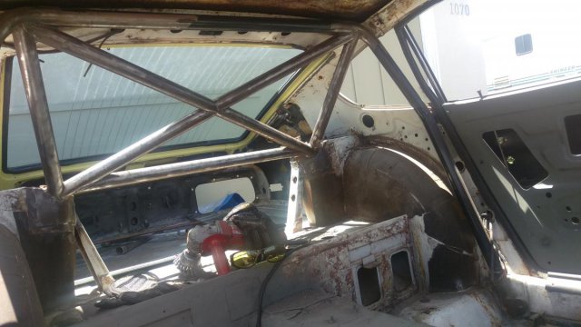

That looks awesome man would love to end up with a set up like that bro. Simple, clean, reliable. Just got done prepping the roll bar for paint. Thank mankind for power tool eh? Haha interior is looking so much cleaner simply with a rust free roll bar haha. Definitely stoked to keep working on the rest of the interior. Surface rust everywhere! From sitting outside for good while haha. Loving the project though. Already imagining the end result.

Hey, you got a car that runs brother, you definitely got the upper hand. In regards to my frame strengthening it definitely needs some work From what I've been told. Seems the rollbar was previously welded on without making bases/pillars or whatever on the floor so it seems IF I rolled, the tubing would penetrante out of the floor and the roof would come down on me. Granted I wouldn't be tracking the csrcar or racing it. But still, looking forward to having a functional safe cage.

yeah that roll bar definitely needs a base even if you sandwiched two pieces of plate steel to spread out the force. If mine was striped all the way I would replace my frame rails with 2x4 steel front to back. I may do something like that and cut some in half length wise to box in the frame. I had a shop do my swap for me so I had to pony up some dough. I'm in the swap for about 12k. if you can do all the work yourself you can do it for about 8-10k depending on how much you get your engine for, and your transmission choice, by the way the manual trans will be considerably more than the auto that will most likely come with the engine. I went with the auto because it's like a 3-6 k difference. but remember it's all the little unexpected stuff that add's up. so plan EVERYTHING before you start the better you plan and research beforehand the more $$$ you'll save in the end. My shop is really good and threw a lot of things in there on their dime I wasn't expecting it's taking for ever it'll be worth the wait
